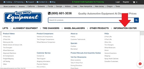

If one goes under the INFORMATION CENTER submenu, some good info here.
https://www.gregsmithequipment.com/
Have been kicking around a lift down the road, found this useful.
