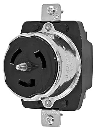

Need to hookup an adapter for temporary jobsite power to Miller Dynasty 200DX. Available is 50-amp, 230-volt, 4-wire receptacle. Welder has 50-amp, 230-volt, 3-wire plug. Should the center pin of the adapter's 3-wire receptacle be connected to neutral (white) or ground (green) or both? Maybe a dumb question, but just want to be safe.

You would just need the 2 hots and the ground going to the welder receptacle, no neutral. The U shaped/ round pin on the 4-wire receptacle is the ground. You better change 230 to 240 volts in your post, some people will jump on you about that.

Jobsite receptacle looks like this. Is wired single phase. Ground is outer housing.

Kevin Essiambre
May 1, 2014
208
Ottawa, Ontario, Canada
OP, you are correct that the outside is the ground on that receptacle. I've attached a photo for reference.
To go from the 50 amp 125/250 twist lock to your 6-50 receptacle you need, you'll connect the ground to ground. X and Y are your power terminals on the plug and receptacle. Ignore the W terminal, that is for the neutral which you won't need.
I'd make a nice adapter cord, maybe 10' long with 6awg cable with the right ends for the cable. Then you'll have one for future use. Or, with 10' of cord, you could just keep changing the male end to whatever plug you need. Either way, it's handy to have adapters for different receptacles. 1c4b66db53f44c485922da900c90700a.png

AngryBeaver
Jul 12, 2017
1,705
Lake Milton Ohio
Kevin is right, except you have a CS8364 plug. the two with the tabs inboard are the two hots. (x and Z) W is not needed on the welder. The center pin in for alignment purposes only
This is a very common plug on rental generators for single phase power and carry one of these adapters on my service truck for running my 200 amp tis/stick machine.
