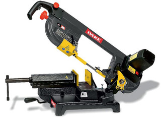

My proposed solution is not going to save you money, but it's very practical and you'll make great cuts.
Check out this mitering horizontal/vertical Hemsaw.
It won't take up much more space on a benchtop than a portaband on a swag table, but will work in vertical mode with the addition of an add-on table. But perhaps most importantly, it makes super square cuts in horizontal mode, and the head miters, which is way nicer than using a swivel jaw vise on a 4 x 6.
I don't have this exact saw, but I have the slightly larger Femi branded cousin and it's one of my most used tools exclusively in horizontal mode.

@GeoBruin has my vote
Tabletop bandsaws are a incredible hybrid that solve your problems.
Femi/HEM Ddo it best, but Tractor supply and others have more economical versions

I believe the Dake saws are the same as the femi/hem saw as well. But only the larger sizes are available.
