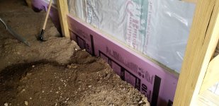

I installed a thermal barrier around the whole inside perimeter. About 15" down, just me a pick axe and trench shovel. That was a lot of work! I wouldn't want that job. I also stubbed out 3" PVC for future water line. 20180510_200723.jpegSnapchat-1027628147.jpeg20180514_175751.jpg20180526_165300.jpeg20180526_165323.jpg

Got the floor leveled out and foam installed. Marked out a permanent spot for the two post hoist, straight in with enough room in front for tool box and mezzanine.
I decided to tape the seams of foam, probably a waste of time but peace of mind. I also used a 8ft 2x4 with a line every foot for marking out the barn floor for pex.20180604_133535.jpeg20180604_102305.jpg
I went with Radiantec for my DIY kit and checking with Menards I could have saved $500 however, you don't get customer service, a pex map of exactly where to lay it and exactly how many loops you need to make it right. They have been helpful and I also like there manifold with pressure test port built into it. 20180605_192414.jpeg20180605_192356.jpeg
I had to fudge there MAP a little bit because I didn't tell them where the drains or hoist pad was going, easy enough to figure that out on my own. I was amazed at how accurate the map was and how I used up each roll within feet.
