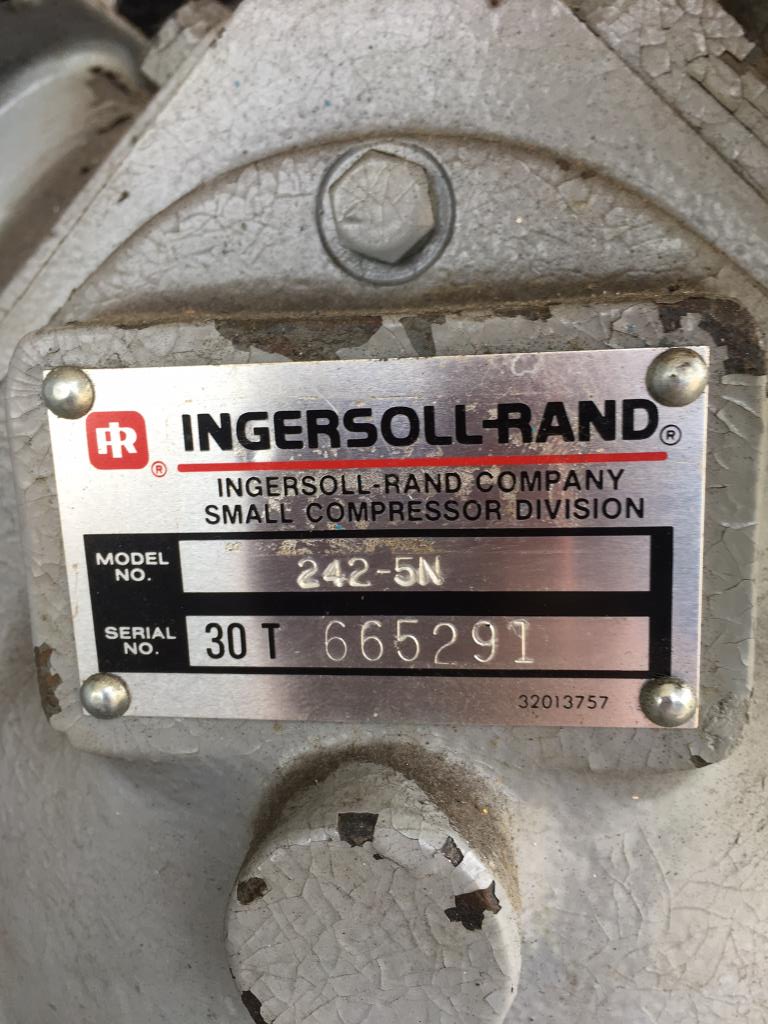

I'm working a later shift today, so I swung by and snagged a couple pictures:

Well hell, I'm going to have to stop assuming no cap housings=3 phase.

Huh? It's a regular single phase motor, caps are in that box on the side of the motor.

It does have a cap housing. The give away is the gigantic junction box on the side. It's far larger than a motor junction box. They stuff all the caps in there.

Below is from the century website, so it is indeed single phase.
Single Phase Capacitor Start Capacitor Run
5 1745 230 22.0 184T V209 1-1/8” x 2-7/8” F REV 15.0 82.0 5,$
7 1⁄2 1750 230/460 32.0/16.0 215T V305 1-3/8” x 3-1/2” B REV 17.3 86.0 5,80,$
10 1750 230/460 38.0/19.0 215T V303 1-3/8” x 3-1/2” F REV 17.9 86.5 5,80,$

Under the motor tag picture there is a connection tag diagram that you're only half showing. I can see clearly there is a reverse swap (8 and 5) for low-voltage. Can you show us the rest of that picture. It is clearly a capacitor start or has run capacitors slightly shifting some of the field windings to provide start direction.
I am not exactly sure why you want to run this on 460 V unless of course you have 460 V. The link you provided 2=>40amp 2 pole, In no way does this double the voltage, and you shouldn't really use mini breakers in a motor circuit. If you have 230 V, you will need a step up transformer to wire this at 460 V. But, then you also have to deal with the contactor. There's a light switch on the bottom of the starter box. The starter coil is probably 230 V. Good chance be this came out of a single phase shop that only had 230 V. They probably have a 5-50 welding plug on the end of it. The previous owner was probably powering it with 50 amps at 230 v single phase. I am guessing that A.O. Smith(The motor manufacturer), just took the design of a 115-230 Volt 4 pole motor and applied it to the 7.5 HP situation. But it would've been silly for A.O. Smith to wire it for 115–230 V. The 115 V would have 64 A FLA. I don't think I've seen a 75–80amp 115 V, single phase breaker. (The wiring and plug would be an absolute nightmare.) The next situation is, if One were to want to hook this up to 460 V single phase, they would probably have to swap out the run capacitors for 600v caps. I have a feeling the run capacitors only have a rating of 370–440 V.
