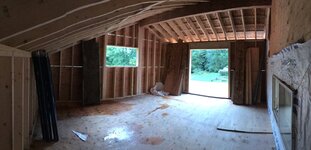

Rafter day. Very happy with the final layout and ceiling height. Had a drink on the deck this evening and look forward to many evenings out there. Mrs Chwk is an avid gardener so the view is spectacular all summer and well into fall.

Roof deck finished and ready for metal... Those prices sure haven't dropped like the lumber.
Need to cut out the doorway from the office and box in some extra headroom above the door since the doorway will be an 8" step up from the office floor. There is a 3x3 landing that will be the second 8" step up to the new floor level where the plywoood is laying on the floor covering the opening.
Had to find a way to vent the joist space under the deck:
