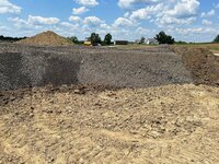

After a couple months of prodding for information, embracing opinions & guidance my pole barn is going up.
I had a lot of decisions to make and this is my one and only building most likely. Ended up for return per square foot dollar going with a standard pole barn type building measuring 48' wide x 40' deep with 14' ceiling standard trusses.
Had to raise the pad a good 5-6' and it took about 90 dump truck loads of of asphalt millings I was able to get delivered for zero cost due to a local project going on about 800' from my driveway. As fast as they could cycle trucks were coming in every 1.5 - 2 minutes and my excavator guy was there in his dozer spreading them out. It was a crazy orchestra to watch and with out the millings I don't think I could have afforded to move forward.

After a few months of a lot of equipment parking on it from dozers to cement trucks it was time to level a couple weeks ago as the contractor for the barn called and said they were ready to build.
