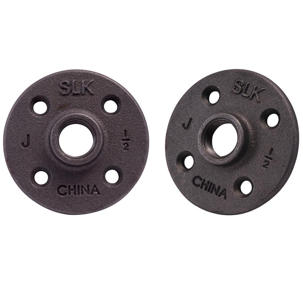

4x4x3/4 plywood, a pipe flange screwed into each corner, a section of threaded pipe screwed into each flange.
Might be a little less expensive to buy 6ft sections and cut to length.
