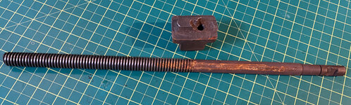

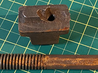

2oolhound
Dec 18, 2010
5,918
BC Canada
Here are some pics of my old screw and nut. Looks like the same issue you're having. You should just buy the nut from the supplier for the simplest fix.
