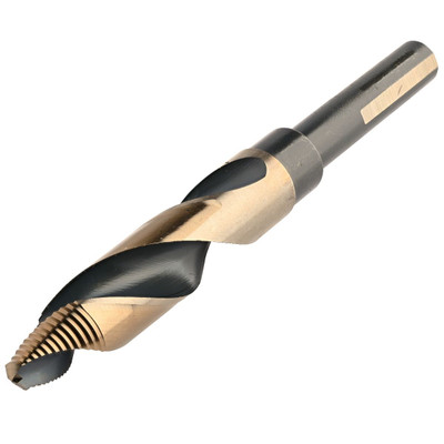

I need to drill 2" x 3/16" thick square tube for a hitch project. I usually use milwaukee shockwave (gold) bits on my drill press with no issue. I can't find a 5/8" shockwave bit.
Can someone recommend a good bit? I've been reading reviews on HD/Lowes and people are not happy with the bits offered on the big box stores sites.

Search Grainger's website, and pick whatever is in stock near you the quickest...? Check local pickup and punch in your zip code.
Cle-Line and Chicago-Latrobe are better than DeWalt and Westward, but unless you're doing a production run, any of these will serve just fine for your project.
As to online reviews of drill bits... bear in mind that the vast majority of people do not own a drill press and do not have the slightest idea how to use a drill or that lubricant is a good idea... even fairly cheap drill bits will usually poke a couple of holes when treated decently.

For 2 damn holes any cheap assed bit will cut 3/16”. If it’s a one off job go on the cheap. Why spend 4-5 times the cost of a cheap bit unless you are running production??
Just saying…..200 rpm or less is your friend and good oil

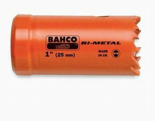

For two holes, about any cobalt bit would work and one should be available at any hardware store. If it were me, and I didn't have one on hand, a hole saw would be coming out.

I like using rotabroach or annular cutters instead of twist bits for larger holes in thicker steel, they work really well in a drill press, and leave a very clean hole.
Any time I'm drilling into tubes like hitch receiver tubes or anything 1/4-1/2" thick, I'm using the rotabroach cutters if I can get the item in question onto the drill press. If I can't, I drill a series of larger holes (starting small and ending up at my final diameter), that seems to go alot better than just giving it one shot with a twist drill.
A cheap bit will work just fine though, use oil and a drill press if you can, and start the holes with smaller bits and finish with the silver and demming bit.

The only thing I'd add is that this is for a through-pin, so alignment is fairly important. Unless you have a good, rigid, drill press and press vise--and the skills to use them right--it's often best to lay out and drill each side separately instead of trying to through-drill them.
I'd step 1/8"-1/4"-5/8". I've found that using a 1/8" pilot increases the life of the larger, more expensive bits by saving wear on the tip of the bit.

something like these ... tungsten carbide hole saws... you want better quality then go get a brand name and paid more. I have the 7/8 Klein for 1/2" knockouts and they cut those steel like butter. Not sure if they have 1/2" hole saws... not a common thing so AMazon or other places.
in the old days, it would be a pilot hole then a silver deming bit like these. since not too many hand drill chuck are 5/8 maybe a good sized drill press.

Best with a Carbide-toothed one-piece holesaw, as they seem to drill rounder and less-oversized holes than the bimetal ones that fit a threaded arbor.
