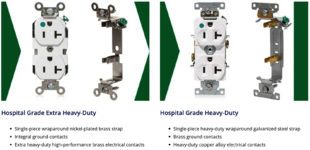

i was looking at receptacles for projects and to replace worn out ones at home, and i decided to start at hospital grade.
generally, it seems the manufacturers make a (regular) "heavy duty" (HD) hospital grade and an "extra heavy duty" (EHD) hospital grade. going deeper than that requires looking at each manufacturer. leviton, for example:
UL construction and performance requirements for Hospital Grade receptacles are more stringent than those for specification grade devices. Leviton Hospital Grade receptacles meet or exceed these requirements. These receptacles are Fed Spec W-C-596 rated.
the HD has an H added to the model number, whereas the EHD does not. e.g. 8300-HW and 8300-W are white 5-20R duplex (the latter is the top of the line EHD).
the industrial, non-hospital-grade is similar:
the main difference i'm seeing is between the EHDs: the hospital grade's strap is plated.
so, in this particular case, is the hospital HD actually better than the industrial HD? there are additional tests, yes:
but will the industrial version actually wear out first or something? i don't think that's an easy question to answer, but i shop for hospital grade just in case.
of course i looked for hubbell first, but they were harder to find at places i'm used to shopping, and they seemed too expensive even at electrical supply house websites... especially the "HBL" models (what hubbell calls EHD) which could easily be $30 or more.
the levitons seemed the most available to me in my search. i just picked up four red EHD 5-20R receptacles (8300-R) because red looks cool. i'm putting them in my desk as like a flush-mount, built-in power strip basically.
i got them from amazon for $14/ea. they were about a dollar cheaper on home depot, but it's not an item they stock in store, so i would've had to get it shipped. i would have gone for 15A ones, but my desk doesn't have to be to code, and for whatever reason i found that 20A hospital grades are cheaper than 15A excepting perhaps one specific color. this was true on home depot's website as well. this seems weird to me because i'm used to 20A always being more expensive than 15A, but i guess normal pricing rules don't apply to specialty stuff like this – whatever they buy in volume is cheapest.
i've seen EHDs as cheap as $8.50 on amazon for the white ones (8300-W), which seems very reasonable to me.
which brings me to the thread title... Legrand P&S's HD 5-15R duplex in ivory is $5.50 on amazon and menards. i picked up two of them to replace worn out outlets in my garage.
and ****, this one's $4.70 at lowe's:
so what's up with these inexpensive hospital grade receptacles? reading old threads on here, i thought they were like $10 minimum, and that was pricing from like 10 years ago.

Before this gets way too off topic, note that the OP is not asking about if they are better, or if they're code compliant, or if he should use 15amp or 20 amp receptacles - he's asking about the differences in pricing he's found.
I'm familiar with spec grade receptacles but never had to specify hospital grade, so I don't have a feel for what they should cost. My only thought is the less expensive ones you found may or may not be authentic...there are a lot of counterfeit things on the market these days.

I wonder if the "hospital grade" ones are any better or just the ones that they chose to pay for testing/certification on
The have thicker/stronger tabs that engage the plug prongs and hold their spring tension longer.
The do have higher pull out force as cyberdyke mention, plus when things are left plugged in. Not a big deal in our house as it’s all heated tile floors so the vacuuming is a cordless Dyson.
That is an odd price? In 2017 when I bought mine they were 25$+ per outlet if bought from Menards. I waited patiently and bought ones off eBay around 4 dollars a piece if I recall correctly

I've used one or two hospital grade receptacles usually where stuff is getting plugged in/out daily.
One of those things I wouldn't spec for the whole house considering some people never even touch certain receptacles.

Hospital grade receptacles are annoying in a residential application. The pull-out tension (which is one of the tests) is way too high. Mama wont like them when she's vaccumming.

I can't speak as to why the Legrand Hospital grade outlets are cheaper than Leviton. But I will say I have yet to be impressed by any recent Legrand product I've purchased. They all seem pretty cheaply built compared to Leviton.

Hazardous locations are different then what hospital grade can handle, I have a couple of the haz location models & they are mini pin & sleeve with cast iron back boxes.
As to complaints about blade tension health care facilities are required to perform annual tension tests, 4 ounces minimum (not all that much) I used to have to do them & they are a PITA, mostly paperwork, but the grounding prongs fail first. The $20 Hubbell HG were great, $10 Leviton HG were also good, but the $6-7 Hubbell HG not as well. The only reason the 1960's Eagle backstab only receptacles failed was they failed the tension test on the grounding prongs.
