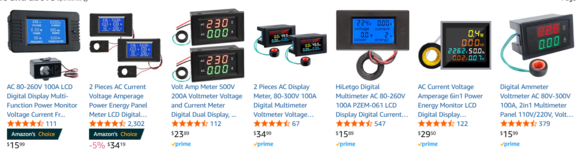

Plenty of these available on Amazon.
Yes that is true, but I had looked at that previously, and it only displays wattage for one leg only, and not both legs. Internally the second leg is not connected up. One reviewer opened the box, to show the monitoring ring only goes around one leg. Several people have also confirmed it only displays one leg. The product description does not mention this though. Definitely misleading of them and other vendors about that in my opinion.

As cheap examples:
A pair of these would work, possibly cut in to gen enclosure if room permits. Worst case bolt on a dedicated box. Not sure how they may hold up to the vibration.
You may need a waterproof rated device or cover if these will be exposed to weather.

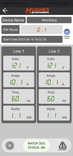

I thank everyone for their insights and help. I ended up going with the below. It works awesome! I used it for a couple of hours on yesterday. The first screen snapshot is the device itself (Hughes Power Watchdog PWD50W Smart RV Portable Surge Protector 50 Amp with WiFi and Bluetooth connectivity). The second screen snapshot is from my phone with the power currently being output by my generator during yesterday's power outage... I ran it to keep my home nice and cool while the power was out... The heating and air company installed the soft kit for me on the AC unit... It was great to do that- rather than to use the two portable AC units we purchased last year. Whole house is better than 2 rooms... Lol ;-)
