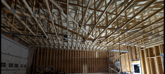

Roof is on and thankfully right before a massive downpour.
And here's a shot with skylights installed. First job of the new shop is to dry out camp gear. You can also see my makeshift hummingbird swatter against the wall. Ok 'swatter' is more of a 'move-alonger'. They go up to the skylights and refuse to come down.
Next big step will be the garage doors. Then windows, inspection and then some foam insulation. Too bad the windows are a few weeks out. Im ready to move in.
