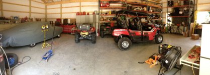

Hey all it's been a while since I've posted. I have an electrician telling me that in my 30x48 metal pole barn, cement floor and 12 foot side walls and sissor trusses that 4- 6 bulb T8 fixtures is enough lighting to light the place bright. This is what his supplier is telling him. I think he's way off base here and not even close. Please tell me the truth...

All depends on what you consider to be bright. I think you should have 8 of the 6 tube fixtures. That puts the lumens at around 110 per sqft., which I think is good. That's using 2800 lumens per tube.
Oops.. made a mistake. I misread your diamentions. With 8 6 tube fixtures it's around 93 lumens per sqft with 2800 lumen tubes. It also better to spread the light out more using more fixtures with less tubes per fixture. 93 lumens per sqft is still bright.

This would be something like a Lithonia IBZ 632 WD which is a T8, 6 lamp, wide dispersion fixture.
Using the photometrics on THIS PAGE click on the "interior" link in the tools menu at the top and enter your dimensions. (click cancel when it asks you to log in)
When I put in 30x48 12 high and select 100 fc at a 2.5 ft working height, it says 12 fixtures.
These are the same fixtures I have seen in a number of Lowes stores and elsewhere. Four of them will give you enough light to keep from tripping over something, thats about it.
8 bulb fixtures (same T8 wide distribution) gives you two rows of four, eight fixtures total. You want more fixtures of less bulbs however, for more even coverage.

In terms of total light output, he's not totally out to lunch. If you're a bright-light freak, it might be a little marginal; but it's certainly not a completely unreasonable amount of lighting, particularly if you will also be adding dedicated task lighting in appropriate places (such as over your workbench).
But the problem, at least as I see it, is the FORM of that lighting. Concentrating everything into just four fixtures, in a space that large, is near-certainly going to lead to very uneven lighting -- at least unless you can mount them a LOT higher than I think you can, based on your description of the building (and note, the higher you mount a fixture, the more of its total brightness you lose by the time you get down to "working height"). I'm willing to wager heavily that if you were to take those same 24 T8 tubes, and put them into 12 two-tube fixtures spaced more-or-less evenly across the room (and possibly at a somewhat lower mounting height, if feasible), you would be much happier with the final result. If you want it to be still brighter, make that 15-18 fixtures.
