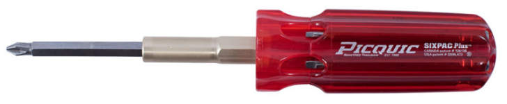

The picquic is a good driver. It will hold and use all the two inch bits I've tried. I've replaced several of the bits that come with it with more useful ones for me and I keep a 1/4 5/16 and 8mm 10mm flip bits with it for those needs.

This might be what you are after. The website says you can use the bits in drills, ect.
Thanks for mentioned Gary. I own one and here are my thoughts:
-The bit change is annoying to me.
-While my bits have done okay with hand use, they haven't held up well to impact use. I've bought probably a dozen replacement bits. (bits are made in Taiwan, not Canada)
-The bit holder somewhat acts as a stubby 1/4 nutdriver but not quite as well as a 6-in-1. The one on mine seems to be aluminum and has a bit of play. When I got mine years ago, they hadn't released the Super 8 Plus with the reversible feature having a 5/16 nutdriver, so that was the biggest deterrent for me. Even with that model, I find the shaft too short for regular nutdriver usage.
-It uses single sided bits, so twice as many needed.
-If all the included bits are used, one has to stay in the shaft. No advantage over an "in one" interchangeable.
-I find the handle to be too fat for my personal liking, and the handle heavy balance is awkward to me.
I know these have a strong following, I'm just not one of them.
