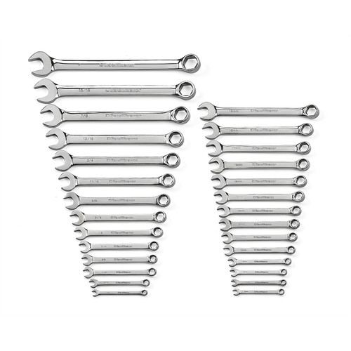

I would personally seriously consider the Williams WS-SC11 set. I linked a picture below.
