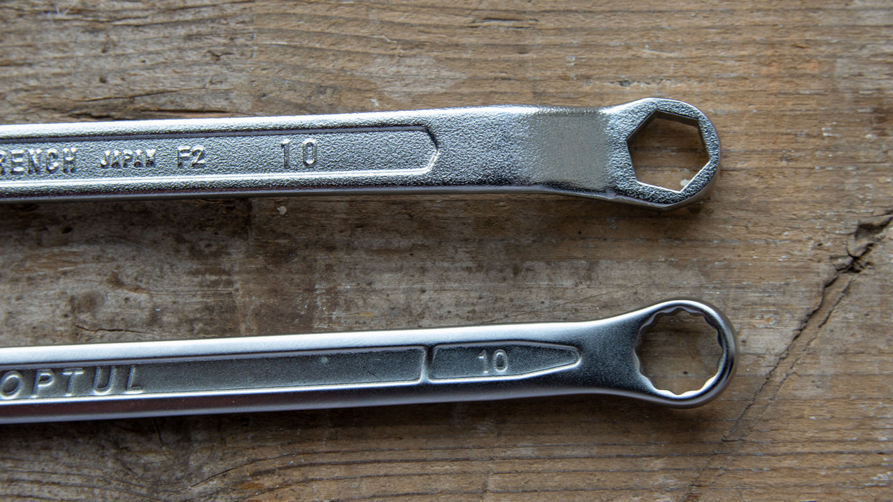

I made very short vid showing the difference between 12 point and 6 point on a worn fastener. I used a traditional flat sided 6 point and more modern 12 point.

Pretty hard to argue against this video. I have came across this scenario many times.

+1 and I shall add this:

But these NASCAR pit crew garage journal members say a 6 point is too slow because they might have to move the wrench a 1/8” to get it on or god forbid flip the wrench over.
I don't think your video is showing what you think it it showing.
Even my 6 point wrenches are off-corner engagement ("Flank Drive".)
Your Japanese wrench appears to be a very old (or very inexpensive) straight sided one.
The Toptul 12 point looks like a decent wrench, engaging the fastener away from the corners. Flank drive wrenches fit differently than old school wrenches for good reason, and are less likely to round a bolt head. IMHO, your 12 point would be a better choice for a bolt with rounded corners - 12 potential gripping points away from the corners.

The bolt is always softer than the wrench, when it mushes, you dont want voids for it to flow into.
Its a matter of material displacement, not contact points.
6 point > 12 point on 6 point nuts and bolts.

Did we watch the same video? Because the Toptul 12 point didn't engage the fastener in the video I watched.
Guy has "california" is his user name. His opinion on rust is irrelevant. :lol_hitti
This right here. Rust/damaged fasteners mean 12 point flat out doesn't work in some situations, sockets or wrenches. It's like the guys who say using a torch makes you a hack. Come to PA and turn that 13mm inner tie-rod - Any tool you like, and I'll pay you $1000.
:spit:
6 for 6, 12 for 12. Even 12 point spline can't touch 6 point, despite what any displays or ads may say. Matco 6-point spline are the best I've found, and it still rounds stuff off. Look at the image below, if those splines gripping in the dead center of a rotted and frozen fastener STILL round it off, how well would 12 point have done?

Point of the vid was to show that 12 point is a significant compromise compared to 6 point on worn/soft/rusted fasteners. Wrench choice was intentional to show that 'off corner engagement' does not make a significant enough difference to negate this compromise.
The Japan KTC wrenches get my :thumbup:

I did not think of it this way before, but it makes sense. I would be interested in seeing a demonstration of a 6 and 12 point wrench or socket completely mushing the nut or bolt head. I think that seeing the results on the hardware would be most interesting.
