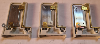

@mm08822 took out the "23.5 - 38.5 Amp Fast Trip Heater Packs" They all look ok except for the far right one. I noticed a little bit of scorching on the plastic. No visible damage on the actual single pack by the screw. I did see a little pit on the plate that is inside, unsure if that's from the factory or what. Looks like those back to back plates (shiny silver and dull) float on top of each other. Photos attached.
Thoughts?

looks like you had a bad connection which was heating up causing arcing. this could cause a trip if the motor was not getting enough voltage thru that overload

@wyliesdiesels Took some time to check all the connections before pulling. Including my 2 hot wires and the copper one and bottom hots to the motor, all tight. The gold connector where the screw goes into isn't that dark, think the photo looks a bit worse. But that plastic burning is heat related for sure. Any ideas what to check?
Here is another shot of the heater pack. Still not sure if that is normal and not a big deal.

I zoomed in on the rightmost heater pack shown separately and next to the screw looks cracked/melted.
Maybe it was loose for some time, started heating up and eventually bound up. So when you went to remove it, the screw felt tight.
Re-assemble with a very light drop of mineral oil/lube just to keep the threads from damaging each other. Maybe swap position of the right one with another.
Damn, I'm going to have to pull them out tomorrow and double check. Don't see that in the photo when i zoom, weird. Eaton used the crappiest screws i have ever seen in these.

...Eaton used the crappiest screws i have ever seen in these.
They look to me like they're PoziDriv. A philips driver in a pozi screw is going to make the screws feel crappy, but using the wrong kind of screwdriver could also explain these weren't tightened properly before.
mm08822
Jan 13, 2012
5,895
That could easily have been the case at the factory. The top right connection even looks bent/rotated down so the o/l block screw didn't engage the threads other than just the leading taper of the screw mate up with the hole. (Red arrow)
This would explain the burn marks and pitting to the right of the screw hole while the left side is clean b/c of no contact.
See if that can be bent back to square (rotated in opposite direction of red arrow) while restraining the fixed end or better yet removing first from plastic base. Chase the threads afterwards before re-assembly with the heater block.

@mm08822 good eyes! I took out the suspected breaker today to look at it again. It's not actually cracked or broken. Must have been a compression artifact in the photo. It does have a bit of grey burn spots on the screw side though.

Forensic pics.
Details/history of "new" starter.
Wouldn't squaring up the lug in the original o/l pac have been so much easier?

(pic)New box installed. Arching occurred again on the far right heat pack as I can see some greys.

I think you are back to the same problem. Those blocks look skewed.
Loosen the copper jumpers on the load side of the contactor so they are not restrained.
Remove each heater block. Re-install each, making sure top screws are actually threading into each copper "lug" beneath the screw.
If the right block is screwed up, get a good one from the old.
Once o/l connections are certain, check each copper jumper position in the contactor lug. Adjust as needed with a couple of needle nose. Tighten contactor lugs.
Spark it up.

Seems clear from the burn marks the overload vented the fireball.
I can’t think of a reason the same right side overload would open both times. If there are no ground faults the current flow in all 3 overloads must be equal. If there were a ground fault the same current would flow thru the center and the right overload.
My wild guess is if you dissemble the motor and post photos of the motors winding, they will not look like clear varnish on copper but will look blackened with cracked varnish. If so that motor is trash.

@mm08822 I agree first thing I saw when I got the box was they weren't exactly straight. But then I am thinking why would that be an issue? So long as the terminals are correctly on and tight, and they seem to be.

So just to refresh. New mag starter installed. Two blue dials on the heat pack set to previous settings. The heatpacks are H2014B and set to M (manual) and D. Today started up twice to test. Both tests, HUGE amount of sparks, more then the old one. Both times. First time, sparked but tank filled and pressure switch set point hit of 175psi. Second time, sparked and tank psi got to about 172 and the thermal overload kicked on and shut it off. Pressure switch air release didn't kick off obviously. It did kick off when I turned it off. I can see arching on the far right heat pack, more then the old box.
@mm08822 I checked all the connections, but I will double check tomorrow. You're saying to bypass the heater packs. What could we hope to learn from that? That would bypass the thermal protection that the heat packs provide right? Thinking about that, could the power coming from the subpanel be causing any issues?
@micromind Damn what are the odds. This one for sure sparks way more then the old one as I mentioned above.
@wyliesdiesels Ok, yeah my Klein def can't do rush in current.
Here is a video of the second time I tried this today. Don't mind me talking I was trying to keep mental notes.
Forgot this is what the bypass would look like?

I don't know what the odds of 2 in a row failing, whenever I get called to a failed starter of that type, I replace the entire overload block, usually with an Allen Bradley one, if it'll fit.
Removing the 3 bare wires and connecting the motor directly to the bottom of the contactor will bypass the overload block and will tell us if the source of the sparks is the O/L block or something else.

looks like the sparks are coming from the overload block. move motor wires to T1 and T3 (first and second lugs) at bottom of contactor.
