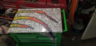

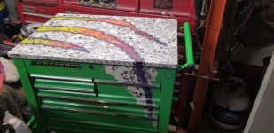

As it turns out, After I picked up the bottom and then a week later the top showed up and I went and got that hauled home from the store, and put them together temporarily and realized how tall these actually were, and since I am short (I am 5 foot 6 on my best day stretching) and the Tool Cart sitting on the top of the top box is 82" inches tall, I realized if I put the top box up 20-22 inches and put the tool cart cabinet UNDER the top box or rather put the cart cabinet in-between like originally planned, It would have made the whole thing way too tall and probably unusable, and I would have been forced to put items way up high that would rarely get used, making a lot of cubic feet of this entire cabinet basically useless.
So I looked into step stools and such because I don't want to climb the front of the box like monkey bars to get to the top and potentially have the whole thing tip over and did not want to go the distance of anchoring it all to the studs in the back wall behind it with chains and cables, that seems like a lot of extra work that if common sense steps in you can prevent a cabinet from falling over and crushing you and your cars so I went this route and put the cabinet for the tool cart in the top section, I had to hand fabricate 2 extension brackets that allow the top box lid to open to a 90 Degree position vs the standard 45* or 50* degree angle that the lid opens to from the factory. So now the top box lid will open and close and the gas struts work properly no interference. (Photos Uploaded of final toolbox configuration in my garage on the back wall, See what you think)
Since I am not a full time professional "Wrencher/Mechanic", and I do this 20-30-40 hours a week at home restoring antique corvettes and fixing my own cars, boats, trucks and some neighbors in need and family members, I decided to rethink the whole plan and at least if I need more space going forward, I can always purchase the 2 end cabinets for each side of the bottom roller cabinet to expand, and at that point, Purchase another bottom roller if needed. However I do not see that happening any time soon, I think I have more than enough space for the moment and once I purchase and flip the house across the street so I can have enough down money to buy a nice BIG house with 10-12 + garage bays and a lift or two THEN i can worry about additional tool box space.
So I wanted to thank everyone who responded and provided advice and information for me with this project. I greatly appreciated the input and time you all spent with your suggestions and engineering advice.
I hope everyone has a fantastic weekend.
