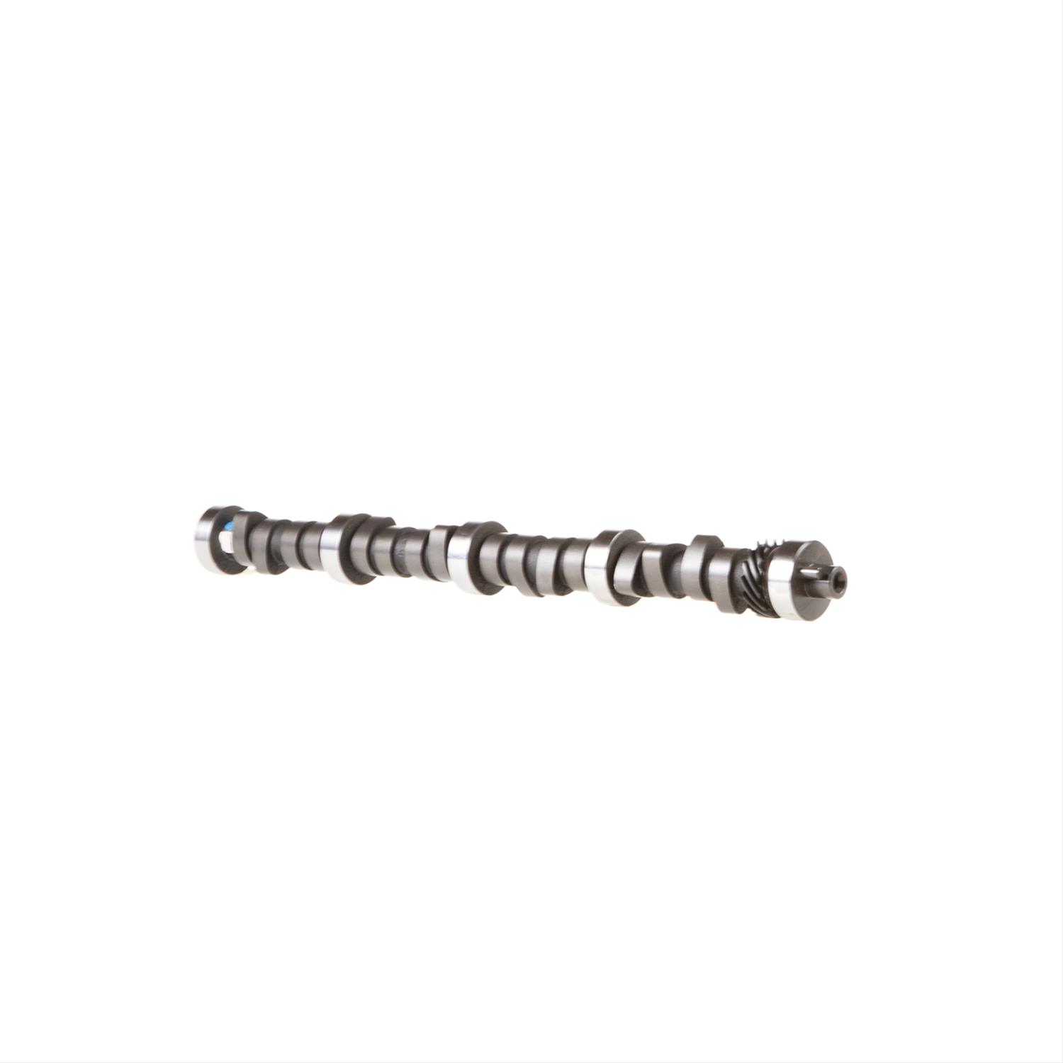

Edelbrock Part #2045 Performer RPM Top End Kit is designed for 1968-87 Ford 460-522 V-8 engines. This Top End kit produced 506 HP & 536 TQ on a 460 c.i.d with 9.5:1 compression.

The edel top end kit numbers come from a 522 ci not a 460.
'506 HP & 536 TQ on a 460-522 Big-Block Ford engine.'
It has the wrong intake manifold (RPM) for a truck application, and a terrible choice of cam for a truck. The edel heads have 95cc chambers, same as stock heads and compression ratio is really low (8:1) and won't support a performance cam. The edel cam has 234 intake which requires at least 9.5 CR, which requires flat top pistons.
Three strikes, complete fail. The kit is for a high compression street strip machine, not a working truck.

Cam timing is dependent on compression ratio. They must correlate/match or you get one of two scenarios:
High comp, little cam = No overlap, cylinder pressure too high for pump gas octane. Ping, detonation.
Low comp, big cam = Lots of overlap, low cylinder pressure, low torque/low power. waste of money.

Example of what a 234 cam can do with good heads. 87 octane.
