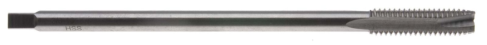

They also make long taps if it would help.

I wouldn't be without my tap sockets, we probably have at least 4 sets floating around the shop and trucks that I can think of cause we never use tap wrenches anymore.
Long pulley taps are really handy to have around too for electrical stuff like putting ground lugs in weird spots in cabinets.
