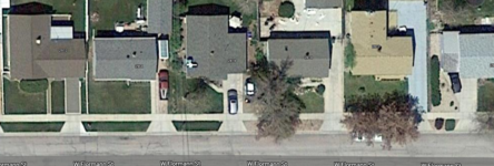

Huh? Since when? I see tons of driveways that are cracked up. Still functional but not acceptable for a slab.
At least in the Midwest the residential sidewalks are layed down before driveways are poured. 2x4 forms and pour away. It gets driven over every time you enter and leave the driveway.
Not here. If there is no house on the lot you either walk in the grass or on the street. Who would put a sidewalk through a driveway? That looks retarded. Lol
