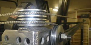

Here are some of the pully configurations.
The first picture show the main post that houses the four cable distribution that is just above the winch. The top bracket is welded at the corner for added strength.
The next picture shows the opposite corner that takes one of the cables over and down to the lifting eye. The top bracket was welded at the corner and a top piece was added to support the bolt holding the two horizontal pullies.
The third picture shows a pully that is the same for both front corners.
The fourth picture gives a close up of the outside view of the pully configuration on the right side.
All of these brackets are 1/4" steel and show no signs of twisting or bending.
Try to over look the springs. I ordered a box of the attachments and went with one type, they make others that are cleaner looking.

couple observations, you should be using forged eyebolts not the hardware store kind you did. also what keeps the cable from jumping off the pulleys if one develops slack from the platform binding or whatever? Nice looking job though
A
akdiesel
Aug 8, 2008
2,617
Wasilla, AK
mrb,
You are correct. I should use the solid eye bolts but everything on the unit is rated for the weight at each corner for a safety factor of approx 3.
The cables are simply held in place by weight like most any cable lift. the pins used are on a hinge and slide on the slotted Uni-strut so that if for any reason the cables fail or it slips on the motor the pins will fall into a corrosponding slot. I have tried to go as fast as I can down to see how well the pins catch. They catch every time but not all completely level.
I had some binding at first but that was due to the alignment of the Uni-strut.
This set up is in use daily since the beginning of this thread and I just swapped over the snowmachines for the lawn tractor, bikes, lawn furniture, etc.

i would change out the eye bolts as they are not load rated. (are the pulleys?) also FYI when dealing with overhead lifting a safety factor of 5 seems to be the standard.
A
akdiesel
Aug 8, 2008
2,617
Wasilla, AK
Good points. I will get the correct eye bolts installed. But I do not get under the load when in travel or not locked into place.

Thanks. The eye bolts are rated for about 400# each. So times that by 4 and it is more than the weight allowed for the shelf and the load.
But, I have thought about closing the bolts or just getting closed loop eye bolts. If that is the correct term.
Unfortunately if your load is not perfectly balanced, I don't think you have any safety factor left at all. And that's bad because safety factor is there partly to account for manufacturing defects, but also to allow for dynamic loading. Fuel sloshing in the tank, vibration from the motor, impulses from starting and stopping the winch, etc. all create dynamic load that is greater than the dead load of the platform, what you're lifting, and friction of the pulleys and rollers.
Also, the entire load (plus friction of the pulleys and rollers and increased load wherever the cables aren't perfectly straight) has to go through the one hook at the winch, so hopefully that's rated for your full load.
Easy rule of thumb unless you get a full load analysis of the entire system is to only lift as much as the weakest component can handle.
I also worry about the way the bolts are being used as locking pins. Bolts are meant to handle uniform tension and static shear load in a hole the exact size of the bolt.
Maybe the pictures aren't representative of how they look once they fully loaded in place, but having it at an angle means there is an angular load on the head of the bolt (the tack welds might help, assuming the heat didn't actually just make the bolt weaker since grade 8 bolts are usually heat treated).
The real problem is that the bolts are just loose in those slots. Normally a bolt in the correct size hole is fully supported on all sides, so the load is distributed across the whole side of the bolt. In your use, the load is only going through the small surface of the bolt in contact with the bottom of the unistrut slot, and the bolt has no support on the other side.
Obviously your lift is not going to fall apart just because I wrote all that... just beware that you have nowhere near the strength or safety that you could have with some changes. You're already being smart and not putting people under or on it. I'd suggest that when you have finished lifting you let enough weight rest on the locking bolts that they wouldn't move much if the cables broke. The dynamic load of a cable breaking for some reason if the bolts are loose would put WAY more load on those bolts than if they are already under some load.
I'd love to see some ideas for a better safety lock. The fundamental problem is that there's a reason normal lift safety locks have flat faces that bear on flat surfaces... to prevent point loading. Maybe you could reverse the struts and bolt blocks inside the channels which a square washer on the bolts could rest on? I like that gravity is doing the work you normally need a spring to do. Also, you have to avoid any load on the threaded part of the bolts... it can't take shear forces.
And to make a long post even longer... I'd add some diagonal bracing in the corners of the lifting frame to resist the side loads the pulleys put on the joints.
A
akdiesel
Aug 8, 2008
2,617
Wasilla, AK
With all do respect to safety, myself and anyone that works with me on anything I do I put theirs and my safety first. The 1/2" grade 8 bolts used for safety pins are well below their shear strength. Each platform is approx. 1300# (including the platform weight and the load) Distribute that to four corners and you have a 325# static load on each bolt. Each strut in column form can handle over 1300#. So a slotted strut will not be able to handle as much of a load as the solid strut but still well below the rated load capacity for this application.
I am not building this to sell. I built this to work in my shop for my purpose as most builds done on this site and many more sites.
Take a look at some four post lifts that are commercially sold (BendPak) with a load on them and then try to move one of the legs. They move more then I felt comfortable with but they still work and are still safe.
Your suggestions are well considered. I like over engineering things to last, but there is a point to where things become less safe by taking out the common sense of things.
