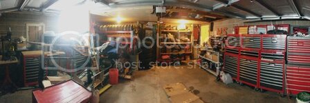

This building has been a lot of different things since 1945. It was the first residence on the property. The owner built this and lived in it with his wife while they built their home. It was a very basic place. Water came from a creek and drained out the wall and onto the dirt. No bathroom, they used an outhouse.
Over the years it got one electrical circuit. It had 3 light bulbs and 3 outlets. I used it that way for a couple years. While it was hardly ideal, I probably only popped the 15a breaker (which was also shared with the kitchen) a handful of times.
The way I was using it just didn’t work for me. Here’s the way it looked on a clean day.
That was not often.
It was a place that was doing too many things. I used it as storage, which got in the way of tools and machinery. I used it for working on projects, which created mess and a juggling/tightrope act that always frustrated me. A lot of times it was an overflow area for home projects. Tools/materials would get put in an empty spot as I continued on with the project. But, when I needed something in the garage it was a task getting to whatever I needed.
I dreamed of making it a shop but I didn’t do anything to make it work as one. I was woken from that dream, continually, every time I tripped over something, stubbed a toe, whacked my shin, tore a pant leg, got grease on some part or me or my clothes or spent way too much time looking for something. I was my own worst enemy.
Over the years as I completely remodeled my home, landscaping, had two children, and did a lot of work for other folks the garage project evolved in my mind. Every summer I take on one larger home project and this year I scratched the plan for a pergola and patio area to get the shop done.

The project couldn’t begin without emptying out the garage of stuff that didn’t belong in a shop. That in itself was a big project. I’ve had a storage condo nearly the whole time I’ve owned this place but for some dumb reason I didn’t utilize that place very well.
Here’s some of what I was dealing with:
Can’t walk between the boxes and the Sami. This was something I wanted to change. In the future, my goal was to keep this wall blank.
A pic that describes how I was my own worst enemy, it was so frustrating.
This was AFTER I had removed 2 cantilever racks and 2 hot rod projects. There was still a ton of stuff up in the loft area.
Seriously, how could anything get accomplished here?

I counted 12 toolboxes in your first few photo's! and i thought i was bad with having 4 in my garage!!! When my new garage is built i'm just going to buy one massive 60" 22 drawer box and call it a day, sell 3 of the 4 on Gumtree, only keeping my old Sidchrome roll cab I've had since i was a apprentice.

Yeah, it got bad for a while. :lol: It seemed like I was a magnet for vintage Craftsman boxes for a year or so. I think I have 6 C-man bottoms, a Snap-On bottom (under the drill press), and 4 tops and mid boxes. While I do have a little room to grow, they're mostly full. I like using boxes rather than pedestals for the drill press and bench grinders.
I have turned down a couple matching stacks of boxes over the years and each time I get a little remorse. Not that I have the room nor the need but I dig the color scheme and they're pretty decent quality. However, if a superb silver/red combo comes my way, I'll for sure grab it. Haha, I'm doomed. :lol:
