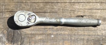

I picked up this little ratchet at a consignment place, not knowing what it was, since it was completely covered in hardened grease and dirt (and since I'd never seen one of these before).
A little cleaning and the Snap-on brand emerged, along with the "G", which I think points to 1945 as the birth year.
After I put it back together, I thought I'd try turning a 1/4" socket with it to check the mechanism, but...it doesn't fit, because it's 9/32". :confused:
After saying a few forbidden words, I remembered that I have the adapter! (I found it a year or more ago; glad I didn't sell it!)
Now they can live happily together.
