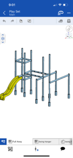

So I may have bit off more than I can chew but I couldn’t resist taking on another project 😆. We got our current playset after it had already had a good long run with previous owners and we’ve enjoyed it for almost 10 years but it’s now to the point where it’s not really safe. We looked around for a good replacement and it’s crazy how expensive the Lifetime ones and others aee and I haven’t been impressed with the materials Lifetime uses. Someone was selling 5” od 1/8” wall tubing in 35’ sticks so we decided to just make our own playset…
Here’s the idea - three levels with monkey bars on the right side and a slide and climbing wall on the left, and swings in the center.
Had to lug the oxy acetylene rig to cut the sticks to a rough length.
So this would be a typical cross bar. I’d take a section of tube and weld it to the bar to make saddles for both ends then the saddles would bolt to the uprights. Thoughts? Is there a simpler way that would be just as secure/more secure?
Can I just cement the uprights into the ground or better to bolt them to cement posts?

I always use a larger base plate and use long anchor bolts set in the concrete. Easier to set them and then drill the plate to fit before welding to the post.

Thanks! My plan is to use 8" sonotube for the concrete bases and anchor bolts. Thoughts on anchor bolts during concrete vs tapcons/wedge anchors? Reason I ask is I have a ton of tapcons and wedge anchors already and an SDS drill, so achoring after the fact isn't an issue - just the question of whether that's a good idea for this application or not.
I'm not an amazing welder by any means, but since I'm doing this as an assembly I can weld up parts in the garage so I'll be TIG welding them since I'm more confident in that vs MIG from a penetration and quality of weld. Still need to test that out though; MIG might work great for this.

Love it BD, this will be fun to watch. Personally I’d base plate the poles. It’ll make it easier to plum them up plus give you a little adjustability if needed. As for the rust, I’d just take off the surface rust then treat them with a rust converter like Jasco. I’ve done some large exterior plate projects doing this and with a good top coat lasted years without issue.
Thanks!! That's a great point on being able to level/plumb with base plates. And thanks for the tip on Jasco - I've never heard of it but going that route for paint prep would save a ton of headaches and time.

Just easier imo to push the L shaped anchor bolt into wet concrete 12" down. I like to make a rebar cage for inside the sono tube and secure the bolts to it before pouring concrete. I also have an sds and tons of anchors but for new concrete I would not use. Mig or stick is what you want for that rusty metal. Tig will take longer and be more finicky. Think about building it so it could be unbolted and sold/moved easily in a couple years.

Nice design BD55. Only thing I might suggest is that 8' between legs is pretty tight for three swings. It is plenty until you get kids screwing around and swinging out of their lane. Collisions can be pretty big deals. I just used treated wood for a similar set a couple years ago and now that the grandkids are getting older took my four swing in 12' down to three after watching several near misses. The pic was when I still had four seats and the kids found ways to misuse the thing even with only three swinging..... Ed.

When you look at supports for traffic lights etc you see studs sticking up out of the concrete. The pole has a base plate on the bottom w/ holes. Nuts are run down the studs. Pole w/ baseplate placed on top of the nuts and another set of nuts run down on top of the plate. I 'think' but am not certain, that the studs are buried in the concrete before it sets. I see 2 advantages to this. The top surface of the concrete is fairly uncritical as far as level is concerned. The pole can be adjusted to vertical by adjusting the nuts until it is right. Decades ago when I first saw this I thought dang I'd rather pull the base plate down to the concrete. But it has been many decades now and the technique obviously has worked out.

With studs or bolts, you may want to think about some rubberized or similar protector around/over the base. Someone taking a tumble doesn't need the potential to land on some piece of hardware sticking out of the ground.
Good point on the 8'. Seems a little small now that I'm thinking about it... I'm wondering if that was a measurement I sent one of my kids to grab off the old set. I'll have to take a closer look at that.

I would have the concrete stop at least a few inches below grade. This would make sure no little ones hit that exposed column of concrete and you (or the next owner) could cut the metal posts and leave the concrete when it is time for this masterpiece to go live elsewhere.

Kids and I got all the tubes cut to length and got all 9 of the 4’ crossbars coping done. I realized on the model that I’d need to do another cope so the crossbars don’t interfere at the corners. I need to make jigs of some sort to align stuff while I tack everything together; hoping this week to tack a couple crossbars and check their dry fit with a vertical.

Did some corner test fits and got some saddles printed to make it easier to hold the tubes for tacking them and also get the standoff distance for the end plates.
Fitup seems decent but I definitely over compensated for the corner interference. There’s about a 1/4” gap there.IMG_3306.jpeg
And the saddles look like they printed fine. I didn’t get a chance to pull them off the build plate before heading to work.

First welds in. Tack welded with MIG. TIG for the actual welds. Around 160 amps, 1/8” filler rod. Definitely need to be more aggressive with adding filler. This weld was a little sunken. IMG_3311.jpeg

Right now the plan is to drill holes in the saddles for 7/16-14 bolts that will thread into nuts welded to the uprights (drill an oversize hole in the upright that fits the nut corner-to-corner diameter then TIG weld in place).
The concern I'm having is welding the nuts to the uprights and if that's an issue. Looking in a few places, it sounds like that's a no-no to weld nuts/bolts in structural applications, but I'd be TIG welding the nuts in place to minimize heat input, and even with Grade 2 nuts/bolts I'd have plenty of strength.
I looked into riv nuts to get around having to weld nuts in place (and would be faster too), but it sounds like they don't like being installed in curved surfaces.
Are there other solutions or will welding in place be fine? I'd assume there's more risk welding a grade 8 nut in place vs grade 2 due to the metallurgy difference.
