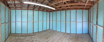

I grabbed a load of 2” foam for the walls. It’s my first time insulating with this stuff and it’s the bee’s knees! I tried a Harbor Freight hot knife, but the utility knife was way quicker.
Since I used 8’ studs, the walls are 8’ 4.5”. I’m tempted to sheet it with 9’ OSB AT $17 a sheet, but I kinda want something with more pizazz. Still undecided at this point.

Quite a difference, good work. I suggest getting 120 & 240V out there. Use the space up by the ceiling for some linear storage for less-often used things. Did you use PT lumber for the floor joists and framing to the sill plates?

Looking good, slim! FYI I had good luck with OSB in my old Pasadena garage. At the time it was the cheapest alternative to accomplish what I wanted. I skimmed it with drywall mud, gave it a light sand, then prime and paint and it came out good. Wouldn't fool anyone into thinking it was high dollar plywood nor as finished as drywall but it held a screw or nail well. Yeah, a little more labor but I (used to) have tons of elbow grease!

I was thinking about doing exactly that. Trouble is, I loathe the idea of sanding drywall mud. I've seen folks on here have good results with OSB, an oil-based primer, and a couple top coats. Later in this project I'll be making some dutch-lap siding to re-do the exterior gable ends. I'm tempted to see if I can make some ship-lap out of plywood for the wall that won't be covered by benches and shelves. Here's the dutch-lap that I made for my last project. The siding was alot of work, but it was VERY satisfying to see those old rough cut boards become something.
