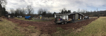

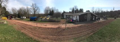

So, how do I reduce costs?
How I’ve always reduced costs. Do things myself.
Step one:
Land cleaning myself.
Step two:
Because the overall size is much smaller I decided to keep my old garden shed for the garden items. It would not contribute to my surface calculations because it was an existing (lol however non-permitted it was when I built it.) so it now needed to be moved to make way.
Also a diy job with the help of my dad and some brothers.
That went pretty well.
Next up:
Site prep another diy project that went fairly well... only got stuck once...

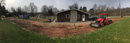

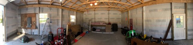

So this gets us caught up to April 26th 2017:
When the big boys took over.
I can still hardly believe they built it in two days..
But they did and it works.
But that means it’s back to DIY for me...

More stone?
And site work
I think pink accent walls are the way to go.

So the progress on this shop has been very slow.
This summer was all work and very little play...
But about all I’ve accomplished is putting some junk on the floor and letting my boys play in it for the summer.
I started hanging some house wrap just the other week. I’m thinking this will help keep the fiberglass off the metal, especially if I have to replace a dented panel or something.
I was hoping to move into it this fall and have heat this year, but a few major truck repairs set my budget back a bit, and I’ll be lucky to have it insulated by spring.
Oh well, maybe tax return season [emoji1745]****[emoji3603]
Still a great place to work on the truck.
