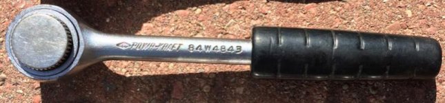

29,377
Username said:
Case in point. Here's my 3/8" drive Wright made Powr-Kraft ratchet.
I believe I might have already posted these in the "Powr Kraft" thread here, but here's another example of Wright-manufactured "Powr Kraft":
Anybody know for sure what (if any) the letter code might have been for Thorsen and Indestro manufactured "Powr Kraft"? Or are those a matter of identifying by design features?
