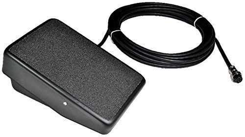

according to the description it comes with the pedal?:headscrat
kkroger
Apr 21, 2013
1,143
Yes, Yes it DOES but not THAT pedal...
The NOVA PEdal I linked to is like this one...
TIG Welding is mostly about comfort and control, if you can't get comfortable or maintain positive control then your quality will suffer, the existing pedal is kinda crappy... Difficult to use, keep track of, keep indexed with while in use...
The SSC, Nova and some other pedals are a lot easier and if you add the SSC/HTP Heel rest to it it is even BETTER... small price to pay for better equipment, the Torch and Cooler are upgrades too. Maybe it won't matter to YOU I just put the links there for others.
