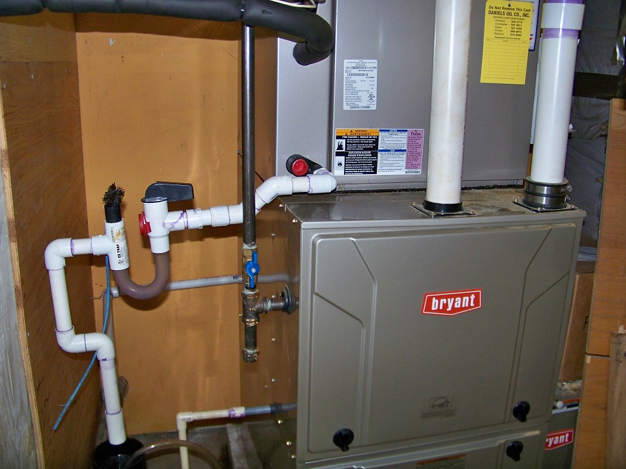

I have a significant air leak between the exterior evaporator enclosure and the coil drain outlet. I’ve confirmed that it’s not the drain pipe connection or the red hole plug next to it. Is this normal or acceptable? The whole system is 3 years old and still under warranty.

Mine has an air leak in that exact same spot as yours and is a very similar unit...
I was "told" that it's normal....not sure if the HVAC guy that "told" me that knew what he was talking about or not though.

Yes it's "normal". If the coil is located within the conditioned space, I leave it. If it's not, I fill it with putty.

if there is a HVAC supply house in your area there is a tape that is aluminum backed with mastic putty on the back that is for this purpose any air not going into your duct work is loss of efficiency

Some thumb gum or ductseal putty will fix that in as few minutes, not really a big deal if it's leaking into the conditioned space.

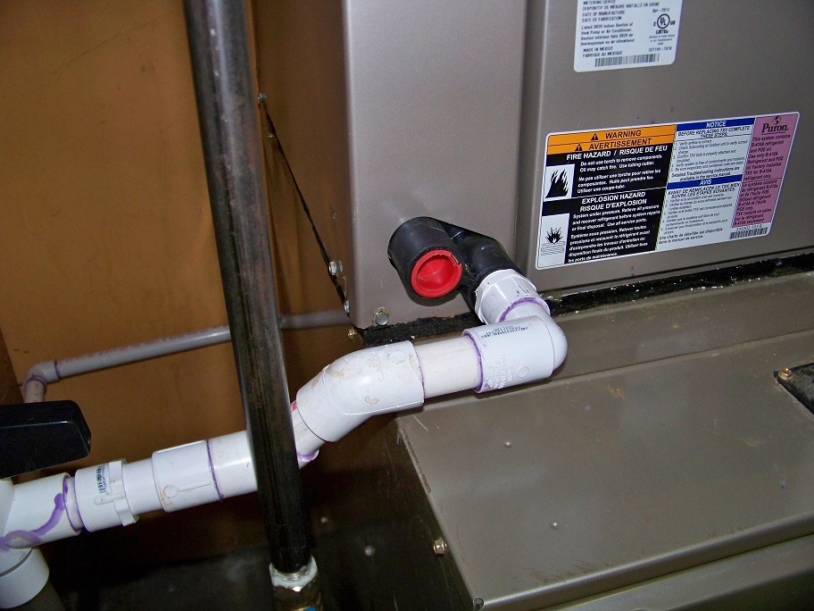

that is a secondary drain port a pvc pipe plug should fit fine.

Oh yeahpak a little thum gum around the drain coming out of the front of coil.

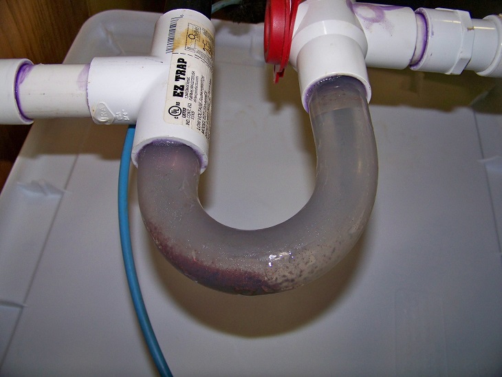

Yeah, I kept the trap cause I figure it's more efficient than having air blowing through the drain. The micro-switch float thingy was never wired to anything anyway. It was a fixed price quote, so I think they just put in whatever they had in the truck at the time.
My new homemade neutralizer looks like this:

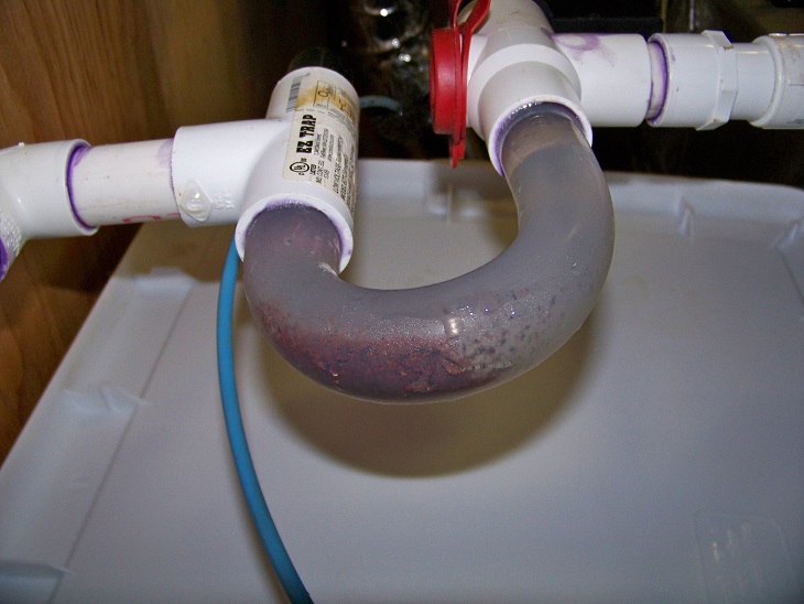

I'm a little concerned at the color of the condensate visible in the clear portion of the trap. Looks like chocolate - is that rust?
If it is, after only 3 years, it's shedding that much? Yikes!
Seal the air leak with metal tape or non-drying putty. Resist the urge to use silicone. It's a bear to get off if you need to remove the panel to clean the coil down the road. Perma-gum is not bad.

The Furnace/AC is in the garage (typical raised ranch with garage under bedrooms). The garage is not heated/cooled yet (installed new R19 garage doors, but still working on improving overall garage insulation), thus part of the discoloration you're seeing is sweat on the clear trap. I'll wipe it off and take a closer look at it when I get home since the picture does look rather brown.
I was going to use silicone as I thought it would be easier to remove than putty - meaning it would all come off mostly in one piece unlike putty. I'll yield to the experienced and use putty.

That's one really nice thing about the clear PVC traps is you can see when they're getting clogged. Makes preventing back-ups and overflows easier.

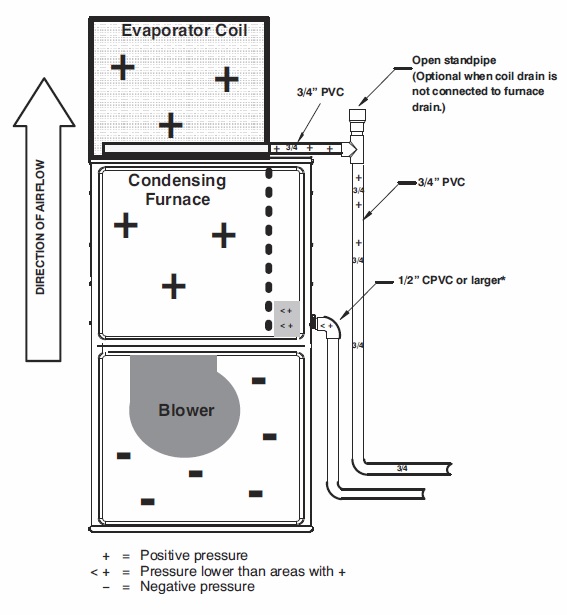

No, it isn't. You only "have" to have a trap if the condensate pan is on the negative side of the blower, that's it. The only good reason for a trap on a positively pressurized condensate pan is to reduce air leakage. An untrapped condensate drain can drain indirectly into any approved "place of disposal" like out into your roof gutter or into a trapped drain or plumbing fixture, like a sink. You can't directly drain into any drainage/waste/vent line, period.

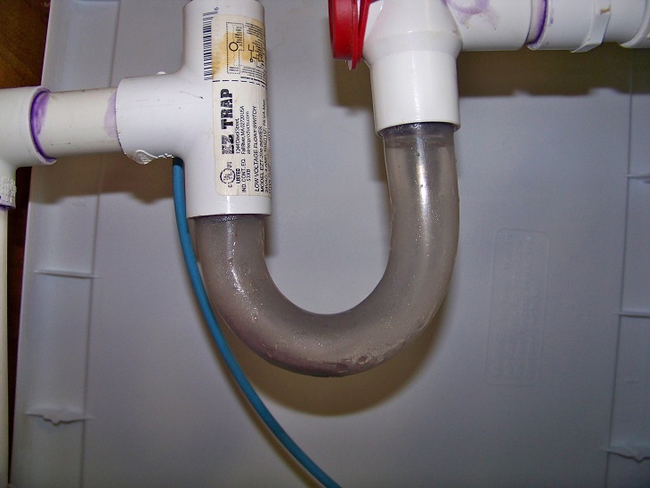

I put a white container lid behind the trap so the wood and walls wouldn't effect the picture color. The sediment there is from the last 6-8 weeks of AC usage. It doesn't look too bad in these pictures. Now I have to ask, what's in there that can rust? I thought everything in there was made of aluminum and plastic.

Ok. You made me check. This is right out of the National Plumbing Code. I called Tom Picherello over at DCA Code Assistance to make sure I am not spreading misinformation. According to Tom, a trap is required on an A/C drain and this is the applicable code:
9.4.3 Air Conditioning Condensate
a. Indirect waste piping from air conditioning units shall be sized according to the condensate-generating
capacity of the units served. Branches from individual units shall be no smaller than the drain opening or
drain connection on the unit. Traps shall be provided at each air conditioning unit or cooling coil to main-
tain atmospheric pressure in the waste piping.

O.K. I see. I have read the installation manual on the Climate Master HP's in my building that I maintained and mentioned above. They did not specify as to the receptacle of the HP condensate drain, only the pipe size. I feel equipment manufacturer's want to stay out of the buildings piping design wars. :)
It is a engineering shortcoming in my opinion, for a large commercial building that has MANY condensating units, for the mechanical engineer to not specify a separate condensate drain piping system that dumps in to the facility's storm drains. Hell, if one is a greenie, just put a holding tank in the facility and use the water for watering the facility plants and such. jmo

I like to pump condensate to a washing machine stand pipe whenever possible. That trap is primed whenever the machine is run. Obviously that's not always possible.
Not arguing, just commenting- You cannot directly discharge into a waste line, period. So if that part of the code is followed, a trap is not needed to maintain the waste line at atmospheric pressure on a blow through unit.
The newer microchannel coils are 100% aluminum. But aluminum fin/copper tube coils have steel end plates. They are galvanized, but I've noticed the zinc coating on recent items is cheaper and much thinner. My 4 year old evap coil is starting to show rust!:mad:
And I check/flush my EZ Trap once a month when I change the filter. Even with 2 inch pleats, sprayed with Endust, and foam tape sealed in, I get sediment collecting in the P trap.
