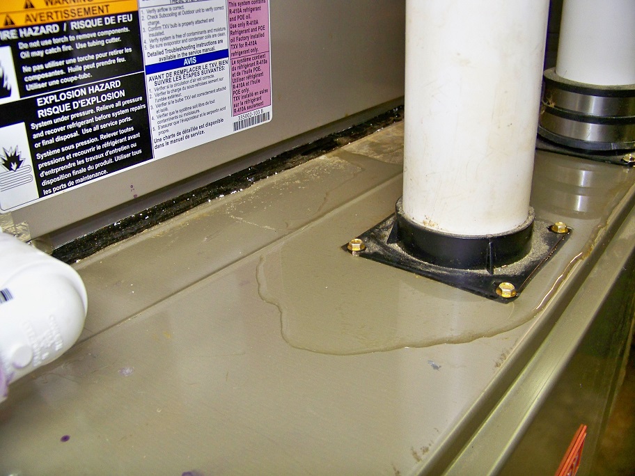

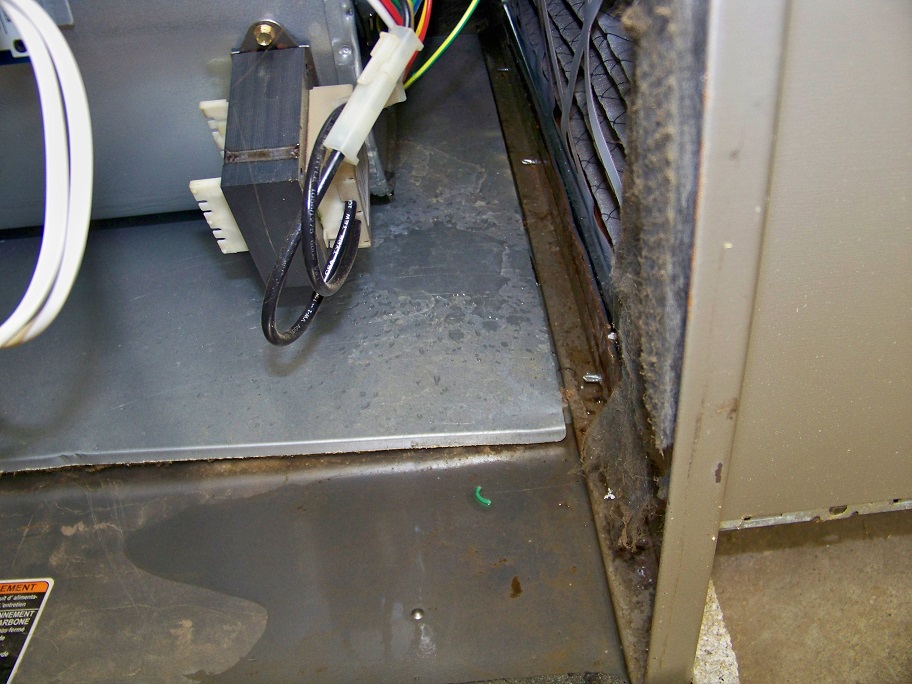

AC is leaking water everywhere!
1. Evaporator leaking out of a screw at left rear corner.
2. Evaporator leaking out on top of furnace.
3. Water leaking through furnace into blower box.
Not sure if it's poor install, poor design, or both. Unit is only 3 yrs. old.
I have called for service, but am interested in other similar experiences.

The purple line is the drain. It is clogged up somewhere along the line.
I thought the same thing so I took the drain completely OFF this weekend. The PVC pipe is clear. What I didn't do is stuff anything through the drain hole into the furnace. (I think I've earned a dope slap for that one).

Gotta be. Blow the line out until it drains, and toss a couple of pan "mints" in to kill algae in the pan so it doesn't clog again.
Pan mints? I get the concept, but that doesn't Google real well.
I've never had the evaporator cover OFF, since it's half covered with insulation. At this point I guess I should probably wait for the service guy.

Why would you put a trap in a drain line like that, you want it to flow as freely as possible....I just used a hose on mine, seems to work just fine. Is it code in your area to use PVC like that? And to use a shut off valve?
rlitman
Oct 18, 2010
24,591
Long Island
The trap is code. Prevents pressure differentials from blowing causing a draft through there.

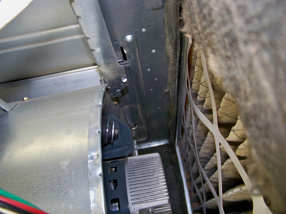

I'm no code expert, but I think a trap is required in CT, however I believe the microswitch float AC shutoff (which isn't connected) is only required if the furnace is installed inside the living space where water would cause more serious damage than the garage.

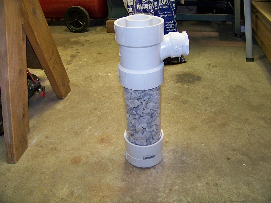

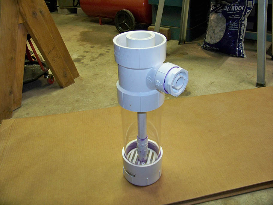

Also, what's the tube full of rocks? Softening the drain water?
Yes, my home made marble chip contraption is to soften the furnace condensate. We'll see how that works this winter.

The piping looks a little busy, but it is correctly done. In fact it may be text book correct. If it has worked for three years, that means the problem is new and likely one of maintenance.
Check the entire drain pan for an algae clog, most likely upstream of the trap and into the pan. That is almost certainly your problem
Why in the world would condensate water need to be softened? Hard water results from ground water picking up minerals. Condensate water is almost perfectly soft.

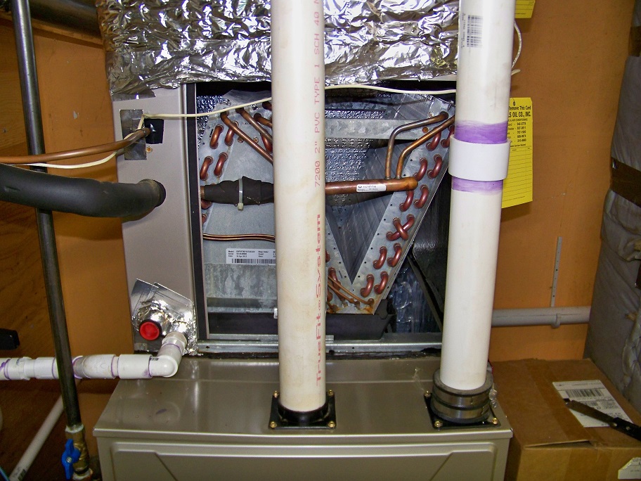

Umm... Clean the coils? Oh ****! If the coils are supposed to be cleaned why would they wrap the access door with insulation? Is there proper coil cleaning procedure? (I'm feeling dumber by the minute).
Would it make sense to install a PVC clean-out "T" at that first 90° bend so I have straight access to the pan? (since it must be clogged inside the evaporator) Or is the cover/door meant to be removed regularly thus making a clean-out "T" pointless.

I misused the word soft. I think it's more Acidic and Basic with the heat side condenser isn't it?
Boy, if that thing ast just a hair higher, it could self drain instead of having to pump it.
Where'd you get the clear? did it glue up the same as the PVC?

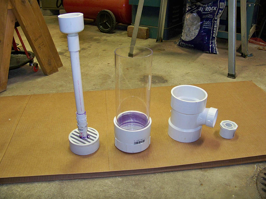

The initial idea was to drain the furnace condensate directly, but learned the hard way that the slow drip-drip-drip caused the water to freeze in the drain line since it runs exposed through an uninsulated shed before it goes underground into a drywell. putting the pump back in solved this problem.
Clear 4" diameter acrylic tube bonded to PVC really good with regular PVC primer/cement. I got it from our plastics supplier at work.

It's very very very common for the pan outlet to plug where it goes into the drain. So if you have to cut the pipe and re-do it, that's what you need to do. Dollars to doughnuts that is exactly where the problem is.
You should exit the drain with a union, capped tee or capped cross so you can swab out the pipe.

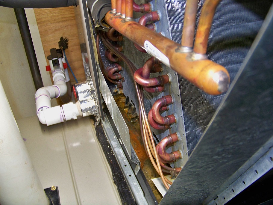

OK, I took the cover OFF. The good and bad news is that the coils look pretty clean and the drain is perfectly clear. (Not the easiest place to take pictures of)
I assume this means there's a hole somewhere in the pan. Like maybe where that crooked screw on the left rear exterior (pictured in first post) is leaking water.

A box cutter will get you into that access door in 2 seconds. You can always close it back up with foil tape.
If you keep your return filter clean, you may not have to clean the coil that often. Maybe as little as once every other year... Though since you are using the same ducts for heat, your hot air will go through the same coil in the winter, which effectively doubles the rate that dirt will accumulate.
I use an aerosol self rinsing foaming cleaner. You use it on a hot/humid day, and the condensate on the coil rinses it for you. Spray it into the intake side of the coil with the fan running, and the fan will pull it deeper into the fins.
If you put in tablets once or twice per cooling season (there's no condensate in that pan in the winter, so no algae buildup), you shouldn't get enough algae buildup to clog the drain. And if you put a tablet into an infected drain, the algae will breakdown and dissolve, though the tablet will not open up a clogged drain. A blast of air will do that trick nicely though.
In your picture, it appears that the AC condensate is draining into your house drain, and the heat condensate is pumped up barely a foot into the same drain. It looks to me (perhaps an error of perspective), that you could get rid of the pump entirely with a little adjustment.
