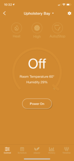

I use Cielo Breez thermostat controllers on my Pioneer mini-splits. The Cielo controllers have a phone app. I program them on and off to maintain temps I want. I tend to use the heat as a binary control on/off at the max temp. This is because my mini-splits only heat down to about 32F outside ambient temperature and I don’t have a thermally efficient building. I have several programs that I turn on and off based on when I plan on being in the shop. I have an off that runs the same time everyday that I always leave enabled. This prevents running overnight unnecessarily.
At some point I will replace these mini-splits with new models that heat down to negative F ambient temps.
This setup has allowed me to minimize my electrical usage and always walk into a comfortable shop. The splits are much more efficient source of heat that electrical resistive heat. We don’t have natural gas where I’m at and our electric rates are the lowest in the country. I do have resistive heat as well. It is all controlled by ecobee thermostats in a similar fashion. I have a thread about the heat control on here.
