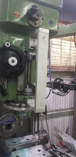

I was using a simple plunger style digital read out on my quill and it did what it was designed to do, (Give me a digital readout of how far the quill moved) yet it did not give me any of the cool feature the other three axis had in the main DRO panel. So I went ahead and upgraded to a magnetic scaled 4 axis DRO and got it all mounted up. Simple stuff once you have done a few of these and I had. However mounting a scale on the quill was a whole different animal and required a serious amount of head scratching and fabrication.
There is a lot of stuff going on on the face of my Mill's head and not a lot of room for this so I had to create it from scratch. It had to be super rigid and not get in the way of the numerous controls.
Using some 1/2" by 1 3/4" 6061 anodized bar stock I created the exoskeleton style mount for the scale. It was the simplest part of the build.
The reader or head was a different story. It is what would actually mount to the quill and I had to recreate the piece that bolted to the quill shaft to a much higher tolerance then the indicator/ stop the mill was originally equipped with. My part would be over 2" long (1.125" longer the stock) It would need to be nearly a press fit into the slot machined into the quill shaft so It required some strong accuracy control as well as precise layouts. I came out very well and worked as intended.

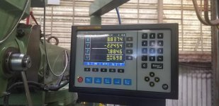

Now I get to see all 4 lines of the display in action.

What does the black handle on the right do? I was thinking about this on mine, but I would think trying to mount it off-center would allow more use of the feed stop and to see the ruler on the left.

Gotcha. Mine is a smaller knob. Issue I would have mounting mine to tbe right is that twoof the four locking bolts for head rotation may be in the way. Possibly could get them with less pronounced heads, and angle the DRO bar, halfway between face on and fully right, but may need one in hand to check.
Was yours pieced together, or bought ad an extra kit?
That is the quill release.
Sent from my Phone 2 using The Garage Journal mobile app
It is a full kit from DRO Pros.
As far as location, I spent a great deal of time mocking this up and experimenting with every conceivable location. (even spent a respectable amount of time designing a remote mount that used a Morse cable off a boat shift linkage I had laying about. I scrapped that as it introduced too much back lash)

I did a four axis on my knee mill a couple of years ago. Funny thing is now I don't use the quill for precision boring anymore I use the knee feed.
Well I can "Sum" the quill with the Z axis and that is beyond handy The DRO lets the two add up their travels respectively and I can do hundreds of operations so much faster.

Just a report after using this for a week.
Having the quill and Z able to sum has transformed how I do any depth cutting. Before I would have to lower the z axis to move a part and raise it back to the position it was at to continue a cut. Now I can just raise the quill, move the part, drop the quill and tune with the up Z and be back to cutting in a tenth the time. I can also raise the quill to check on the cutters condition or even to just clear chips all the while not worrying about getting back to exactly where I just was.
This fourth axis read out was one of those things I did not know I wanted until I had it.
