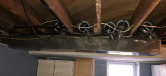

They really chiseled on the ductwork. Fiberglass board for the 2 main runs in the basement and flexible ducts everywhere else.
Cold air returns use the stud bays, no ductwork.

Unico would be the next suggestion if you are dead set on adding more equipment. This is the only thing you will get into a 24 x 24 opening. Duct layout and sizing is critical to avoid noise problems, but every last bit of info you need to install it correctly is online.
But I bet that I could fix most, if not all, of the problems with some fancy ductwork in the basement.
Thanks for the response. I do realize that equipment/ductwork in the attic is not optimal to say the least and I expect that an access point will need to be added in the upstairs hall which my wife will hate, if an air handler is installed in the attic
Can you elaborate on your fancy ductwork statement the basement?

flex ducts and fiber board are "suboptimal" but that doesn't mean you can't build a system that performs with them. most of that is adequately sizing and installing them.
for example, maybe you need to step up from a 6" metal to an 8" flex to get the same airflow due to increased resistance. but if the air gets there, then you get the cooling.
on a greenfield install, (which is common in new homes around here) with a single stage furnace and AC, they'll do one damper and duct run for upstairs, and one for downstairs.
I didn't have the room or layout for that, so I had the main trunk put back in (the previous owners deleted it and duct-o-pus'd it), and then had takeoffs put in for each duct.
I did 4 zones (upstairs, downstairs, basement, bump-out dining/kitchen), with 11 dampers (one per duct), they're wired up into 4 groups.
the basement zone really serves to NOT heat/cool the basement but still allow air circulation in fan call (vs always going down to open/close a vent).
keeping the upstairs comfortable in the summer is a runtime issue with the system I have, not a system size issue.
once the downstairs satisfied with a single thermostat, the house was the temperature it was. having the fan set to "circulate" on the thermostat helps, but not enough. upstairs was regularly 80F into the wee hours of the morning unless you set it to "ice box" downstairs.
now, the system just keeps cooling the upstairs until the upstairs thermostat hits the setpoint and satisfies. it functions pretty much like any other separate system would.
on the extremely hot days (95+) occasionally the upstairs will get +2F from setpoint, but it comes back down in no time at all.
replacing the equipment was done for a handful of reasons - finishing a partially done remodel in the past left the chimney in the middle of a room, so to get rid of it, the 80% heating appliances had to go, and since they were aging out anyways, well this is GJ, might as well go overkill!
also it's important to note that because my cooling is single stage, each zone must be able to flow enough CFM to keep the system happy, without going over the TESP of the system. that got napkin mathed out, and verified with testing.
my heating is 2 stage with outdoor reset (air temp goes up as the outside temp goes down) - it's incredibly quiet and I can barely tell it's running, vs the roar of the old unit.
