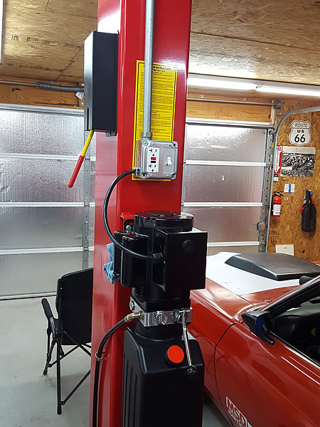

Got the power done, added a double pole switch to isolate the lift power.
Air will be next. Bolted unistrut to the lift post so I could run conduit and air pipe on the same supports.

Power and air on both posts of the Rotary SPOA10. Extended drops before the FRL allows a quick check/purge for water. 220VAC lift power overhead from the ceiling. Second pic was before it was plumbed/wired.
