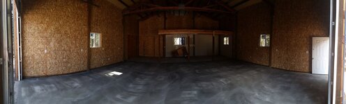

I did the exact thing about 15 years ago in my 30 x 60 building.
Started as a dirt floor building, and poured 4 inch of concrete.
Dug out old dirt, added gravel and compacted it down. Used laser to help
set heights, and once all was good, poured and finish.
If I remember, it was like 24 yards or something. 3 trucks.
Wheel borrowed most of it, and took our time. Total of 4 guys.
Nice thing is when it comes to finishing, most of it is covered, and out of
direct sunlight, so not fighting that time crunch.
As far as your service lift's, you will want to check with lift MFG for their requirements,
for the posts, but the rest of the area can certainly be 4 inch thick.
No regrets, and you will love it.

If your pole barn is a true pole construction the slab is almost always poured after the poles are in and metal is up. Only difference is your dirt floor has had a lot of time to settle and pack which if it’s the right material is awesome for pouring on. Stick frame the concrete is poured before the building is up.
You may need to do some exterior detailing with the bottom metal etc after the floor is poured.

If you look through my build thread you can see that the poles and the roofing was on, then the concrete was poured, followed by the siding. So yes you can do the floor in an existing building. We poured to the top of the lower girt and used that for one end of the screeding board. build is linked below.

I’ve never seen on built any other way. When you pour after, the skirt boards are the forms and you don’t have to worry about rain. Nail boards across the doors, fill to level with 53s and pour the concrete. Soil isn’t disturbed so you have a good surface under the floor.
