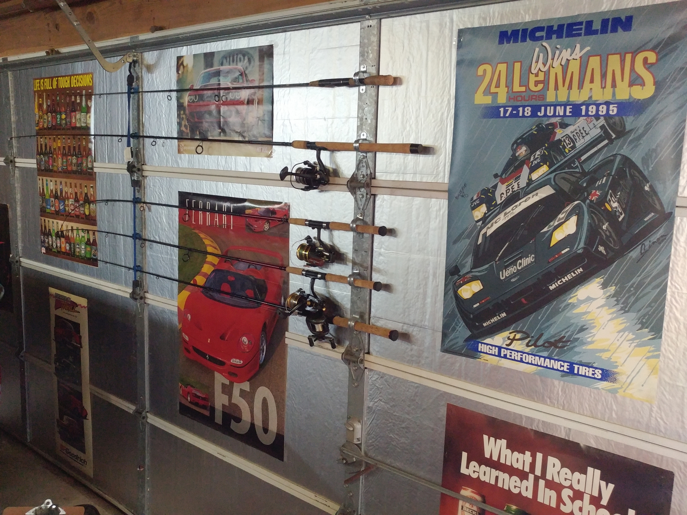

I bought the kit from Home Depot it went ineasy and does very well...slick plastic material on 1 side...trimmed around the windows with foam trim and caulk adhesive.

967
Seabrook, TX
