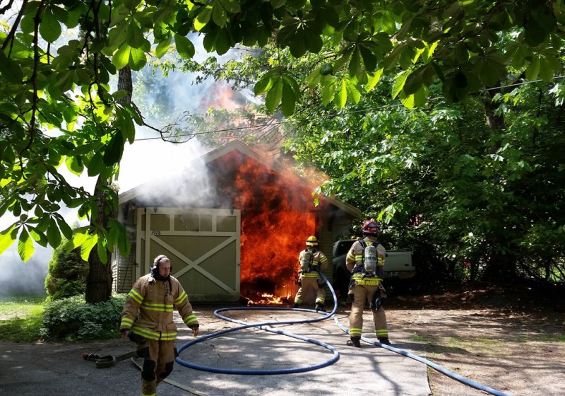

I opened this older thread while researching my desire to add a fire alarm to my detached garage 30 feet south of my home.
Loving all the suggestions and advice...like the NEST but that is way too expensive for what I want to spend to do a start up but I am still considering it since my old 720p Swann video system in the house has went on the fritz. But that is a whole different topic....
Some of my facts in determining a cheaper solution than the nest....
The garage is heated to 55F-60F, 24/7 during the cooler seasons with an open flame Procom ventless 30K btu furnace since 2010 and it works well for my application.
View media item 79299
It is the main reason a keep flammables in a metal cabinet on the other side of the garage and want a fire alarm, better late than never.
Seeing Geddy's Garage thread that documents his destroyed garage is another good reason to get an alarm.
I however would like to do it on the cheap, less than $100.
I like the idea of a wireless comm unit to the house as I don't have a dedicated underground comm wire from the house.
I like the idea of wireless...like the first alert...
...BUT, the ventless furnace is the unknown as far as the sensor throwing false alarms so that is why I also like the suggestion of a rate of rise heat detector.
I want to mention, the 30 amp hard wired service I do have running underground is also supporting video off of a Swann video server communication via addressable IP so any wired comm thru the power wiring might interfere with my video cameras.
View media item 95812
....and why I like a wireless option.
So it would be nice to find something like the First alert with a wireless rate of rise heat detector....any new recommendations (with IP address links to your product please!) for such a product I can but install for under $100 range????
What are you doing to catch the first sign of fire in the garage???
