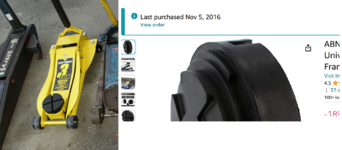

I recently purchased a HF Daytona Super Duty 3 ton Jack. It has the basic rubber pad.
I decided to upgrade and get a thicker rubber pad (https://www.amazon.com/dp/B01H46MXO8?tag=atomicindus08-20) instead of using a hockey puck. The OEM pad was on there good and did not survive the removal :(
Can anyone recommend the correct adhesive to use to keep the new pad in place?
I am looking for something semi-permanent to avoid slipping. I was thinking either hot glue or 3M Windshield Ribbon Sealer (tar like super sticky substance).

"Gorilla Snot", AKA Permatex Yellow Super Weatherstrip Adhesive, would be perfect for this. There are other brands, too -- 3M and others make similar adhesives meant for adhering rubber trim and weather stripping to painted metal.
I wouldn't use hot glue; it has a little flex, but not much, and would be likely to crack and come loose. I suppose the windshield ribbon would work if you have some lying around that's still gooey, but I certainly wouldn't open a package or buy more just for this.
In all, this is a pretty low-stakes application so it's hard to go wrong. Even if the adhesive fails the worst that can happen is a few seconds of inconvenience.

Question, is the Permatex removeable? Advice on Amazon was not to use adhesive (so you can use it on other jacks) but the pad has some room in the cup to move around. Defeating the purpose of not using a hockey puck. My goal is to have one less thing that could potentially slip.
I do have some of that 3M ribbon sealer - seems to last forever and it can be removed.

Trim adhesive is pretty tenacious stuff, but it can be removed if needed. If you're replacing weather stripping, for example, you'd use a solvent to get it off the car.

Thanks. Most of the posts in response to my question on Amazon state no adhesive is needed.
I'm thinking that I want to anyway and will try my ribbon sealer which I have on hand first, then go to this stuff.
However, in the reviews I noticed people said trim adhesive will not stick to painted surfaces only bare metal. Have you tried on painted surfaces?

3M VHB mounting tape is another good option. It sticks like a hot damn, but you can pry and peel it off with no residue. It's used for mounting metal, rubber, and plastic trim to metal and painted metal.

I've had that same jack pad for a little more than 7 years now. Still like new. I've not yet been able to hurt it. I never thought to try to glue it down. It stays put under load, even when I do occasionally use it on a different jack that just has a bare metal saddle.

3M weatherstrip adhesive, as we referred to it in my racing days "yellow death" because it would stay on your hands for the rest of your life, hot melt glue (which is what I used to attach a hockey puck to my jack five years ago and it's still holding strong or, if your really serious, PL construction adhesive. All will work.

Did you keep the OEM rubber pad on your Daytona?
My thought is if I don’t glue it I would be better off continuing to use a hockey puck. Since I recently undercoated with surface shield I’m getting more nervous with the possibility of slippage.
