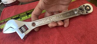

this one is not mine, but I found it an interesting specimen:
I like this idea. Might make one for my go-bag. My only quibble would be that I think the crescent wrench should face the other way. So that the rounded end of the adjustable wrench could be used for tightening with a socket. Now that I have typed that, maybe loosening is the better direction.
