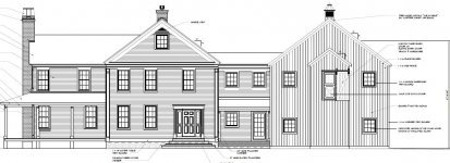

Hello GJ! Bear with me as this is a little lengthy, but I want to give enough background.
My wife and I are in the midst of building our dream home – a “new old” house. The plan is such that it looks like an original 1840’s Greek Revival farmhouse. Garage will be an attached “Barn” connecting through a mudroom that looks like an older addition to the original house. We plan to be here permanently (I am 37). While we do have a budget, we also don’t want to take the cheap route if something makes sense.
So, I have a completely blank canvas to work off of, and I wanted your input/advice so I don’t smack myself in the head when it’s all done and say “I should have thought of that!”
The garage will be approx. 30x40 with a roughly 10.5-11’ ceiling. It’ll have (2) 16’ bay doors. Walkup “loft” over the garage will be insulated and heated, used as a workshop (primarily woodworking). We have 4 vehicles – 2 daily drivers and 2 toys – my 2000 Camaro SS convertible, and my wife’s 1974 BMW 2002. The house is located on a dirt road, about 1 mile off the paved road…so, the DD’s especially will certainly be dropping a nice coating of dust and mud in there.
I’m a shadetree mechanic… I enjoy working out in the garage, but it’s not a daily thing. I’m not a welder/fabricator/etc. I am rough on the floors with jack stands and jacks and whatnot – which has me shying away from doing epoxy.
I do plan on running a subpanel with 20 amp circuits out there and many outlets. Although it’s not needed right now, I would like to have a 220 service out there for future expansion. I also plan on running 4’ LED “tubes” on the ceiling for lighting, and jackshaft openers with the garage door rails as close to the ceiling as possible.
Any advice as to:
Floors – unfinished concrete seems like it’d be a mess with the mud/dirt coming in on the vehicles. As mentioned, I am leery of epoxy as I know I will be rough on it. What about grinding/polishing to a semi-smooth finish or some other type of penetrating sealer just to facilitate easier cleaning?
Heating – considering radiant (or other) heat just to keep it from being an icebox 6 months out of the year. Does this make sense for a daily use garage? How expensive would it be to operate – I don’t need a $100+ monthly cost for the garage? We’re in SE Michigan, and the garage only shares about 13’ of wall space with the house, so it’s primarily comprised of exterior walls.
Not overly concerned with compressed air supply as I have a hose reel and will be finishing the interior in a 1940’s industrial type theme – if I need to surface mount tubing/piping in the future, it wouldn’t bother me.
Thinking I may put a utility sink and hose bib over on the wall adjacent to the house.
Any other things I am not thinking about that you’d recommend?

stm317
Aug 8, 2017
1,339
That will be a really nice place when it's done!
I'd try and set the ceilings at 12ft or just over that in case lifts are a possibility in the future. You can certainly find lifts that will fit under shorter ceilings, but going to 12ft ceilings will provide a lot more options for you.
For the floors, being located in SE Michigan, you need to pick something that will withstand road salt. I'm told that polished floors do not handle road salt very well. If you want that look, a burnished sealer can get pretty close. A clear polyurea coating might work too, but can be a bit soft without additional clear coats on top. The flooring section is a great place to ask specifics and get some advice from very knowledgeable vendors.

I really recomend that if you can add a steel Ibeam to install a trolly on and chain lift, that would be great for unloading heavy things from the back of the truck or even lifting heavy things onto a bench

I would go higher than 8' on those doors.maybe like 12'.

Hard to read the plans but it appears there will be a column in the middle with stick 2x12 joists @ 16" OC on each side. The column supports what? Likely a steel I beam. If so, with only 11 ft ceilings, that beam would give you only some 10 ft or so under it. Would that and a central column be acceptable? On my 30 x 38, we evaluated steel, engineered joists, stick built and trusses and ended up with trusses being the least costly, fastest installation and a flat ceiling throughout. Also plenty of room in the attic above for a future apartment.
Just some thoughts. I personally would avoid steel if at all possible unless you are planning a rolling hoist attached to it.

Nice looking place. I think it would look even better if the garage doors were 2-4 feet higher - more exterior window/door balance.
Floors - Tile would probably work best for your described use, but re-purposed carpet could be a budget option.
Heat - Not sure that less than $100/month for heating in that big of garage, under daily use, and in SE Michigan, is realistic. How many hours/day and what indoor temp are you expecting? Are you willing to spend thousands more up front; for the ultimate in insulation/design and/or solar heat options? How many 'sun hours' do you get per winter?

My advice is during the build to do anything inside or under the foundation you think you might want, as well as the prep work for other systems.
Ceiling height - I would consider 12' a minimum height for a building this large. It doesn't cost that much to add more height now, but there isn't much chance to add it later.
Bridge crane - I would consider adding the supports for a large crane. You don't have to add the crane itself right now, just pour the footings and and add the columns.
Radiant heating - adding it during construction costs nothing, or close to nothing to bury the hoses. But its impossible to add. Even if you don't use it now you might as well add it if you think there is even a small chance you would because this is your one and only chance. Worst case you cap the lines and fill them with antifreeze and ignore them for decades. Or you could use it with a pretty low set temperature, say 50 degrees. So it isn't trying to keep the space comfortable, just reasonable.
At a minimum run a gas and water line to the interior. Again even if you don't use them its a lot cheaper to run them under the slab than to add them later. But in my ideal shop I would have gas heat and an instant hot water heater supplying the wash sink and a hot water hose.
Do you want a 2 pole lift? Then make sure the foundation can handle it. Do you think you may want a balcony or a porch, then add the supports in the walls now, even if you don't do the build out now. My goal would be future proofing. It may mean building in things you don't ever use, but at least its there.

Personally I don't like the 4" concrete curb. I can see an extension of the step/landing but I think it robs you of continuous space.
On the parking side, I would try for the 1/16" slope per foot, it will help water drain naturally without having to constantly push it out. Other side I'd go for level.
The 2x6 walls if insulated should be pretty nice performing. One thing that's working against keeping the bottom warm is the easy path for heated air up the staircase, which will lead to heat concentrating in the top level. Definitely need some kind of well sealed door (like an exterior door) and possibly a ceiling fan(s) to keep the air mixed. I would choose a hanging heater, I think it works well for ramping up the temp relatively quickly. The thermostat can be wherever you want it. I need about 4 ccf per day to keep my shop of similar size at 60F for roughly 8-10 hours, that's on a weekend. I let it bottom at 35F.
Subpanel at 100A would be what I choose, feed it with 60A should be good enough for most all needs.

I'd probably limit the steps from the mudroom level to the garage slab to one direction of the other, they seem to take up a lot of space.
Consider a higher live and dead load for the workshop above. Even just going to 2x12 at 12" o.c. and/or 1.125" plywood on the floor will tighten it up if you have a bunch of woodworking materials and tools up there.
You've chosen a very cost-effective shape for the upper 'barn' portion. I think the 'barn' mass could have more interest however, albeit at a higher cost. Proportionally, I'd go lower on the upper woodshop plate height, say 6', and pop up the windows with small shed dormers. I think it'd create a more interesting space upstairs.

1) If you go with 12' ceilings for a lift....go a little higher. You will find that many lifts require 145" or a little higher ceiling height.
2) Go for large doors. Mine are 10'wide by 8' high. They still don't seem all that wide!! 12' wide would be great!
3) If you run water (you should), put in a full bath with shower. Also include a utility tub outside the bath.
4) definitely heat and AC. This means good insulation.
My minor errors were the 10' wide doors, 12' ceiling height and no shower. All else is good.
Oh - don't go cheap on the drywall contractor. I did and I'm chasing/repairing cracks.

I'd go a little high on the electrical service to the subpanel, for possible future electric car (or two) charging.
And make sure that it's high enough so there is no chance of snow melt or rain water running in.

On the ceiling height- you get get the 'added' height by dropping the floor 12" or so- since the garage doors are on the side, from the front view it will look the same- just be a 12" or so stem wall inside. Agree 12' should be minimum

No offense .. why are you attaching ? That was typically not how it would have been done ... especially a barn ?
Properly done -- concrete is durable and slip resistant and makes for a nice garage when cars are involved. It can be colored with Sika products as it's being finished -- my NYC loft was all Sika colored concrete. It can also be colored at the plant -- I did this on a project at my shore house. Polishing would make it too slippery and tile to me is to fix a bad concrete floor.
nothing like a radiant slab -- sinks are nice. With all the cordless tools -- outlet are often overdone.

I'll see what we can do about the 12' ceilings - I may be a little too late on that at this point. Footings are in and they are currently framing the house.

Thanks - Would tiles hold up well to jack stands and a jack and whatnot? I always assumed they'd chip and whatnot.

If I can't frame the ceiling higher, maybe I can find something larger than 8' - didn't even really think much about the doors as I know standard used to be 7', and we have 8' in our current 3 car. Good point, though, to see if I can get them taller.

You are correct, steel beam - It is a little unfortunate, but my thought was I'll have ~15' between that beam and the door, so I still would have ~11ft of ceiling height for a lift/clearance. Car hood/trunk may be under the beam, but I figured it should be doable.
Reason we didn't go with trusses is it maximized the loft space and really didn't add much cost to go traditional built. It did sacrifice garage with the beam.

Good point on the doors - I'll see what I can get, if there's anything taller. Was concerned that tile could/would chip and crack with jack stands and dropping things. Is it that durable?
Heat - that was my thought, it'd probably be fairly pricey to heat in the winter. As it stands, I rarely get out there (work, 2 young kids, etc). Sounds like maybe provisioning for radiant heat (tubing in the floor) now so I can add the mechanicals later may be a good idea. Probably not worth it to heat it now with my lack of usage, but that could change down the road.

Good ideas. I planned on a 4 post lift, but even at that, I can have him pour 1/2 (or an appropriate section) with thicker concrete - I assume that's a small incremental cost right now. I'll see what I can do about ceiling height at this point in the build.
Something like 50* was my thought - just something to keep it from being totally frigid out there. I plan on doing the same with the workshop above...heating it, but not trying to keep it at 68* or anything.

I see what you mean with the curb - I'll think about that. There's still time to change that. Really good thought on the sloping - wasn't even thinking that the "toy car" side could just be flat. That would be really nice.

Interesting on the design thoughts - I appreciate it! I'll sketch it up to see how it'd look. Also, good advice on the framing - I'll see what we can do and the cost to beef that up a bit.

Thanks! I'll see about going with a higher ceiling - didn't realize most lifts require a higher ceiling. I just assumed most lifts were 8' or less, and then you basically lift the vehicle as much as you can before you smash the ceiling.

We liked the balance...we truly like the attached garage convienences, but having the barn look worked out nicely. Saves us from adding multiple outbuildings in the yard. We have 4 acres, but want a more natural looking space - don't want to look out the window and see a pole barn. Also made it easy to sell the wife on the workshop when we had all that extra space to get it to "barn height" ;)

They just started framing the garage today. It would be too much of a mess to change the ceiling height, so I should land in just over 11'....not quite the 12', but I can deal with it.
I do have the framers lifting the headers up for the garage doors as high as they can. We'll see where they fall once concrete is in, as well as what garage door options are, and we'll put in the biggest we can considering cost/benefit.
I also have him framing the 2x12 floor joists at 12" on center to give that workshop area some additional strength.
The other considerations you all mentioned will be addressed as we move towards those points in the project (tubing for radiant, etc)
