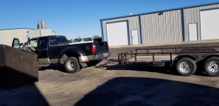

Whats the drive up access like?
Im looking at doing a 30x40 on a new piece of property, but will have only 12' wide of driveway access to it. Im planning only a single 14' door(plus a man door) on the 30' side because I would have no way to use either a wider door OR 2 doors...
