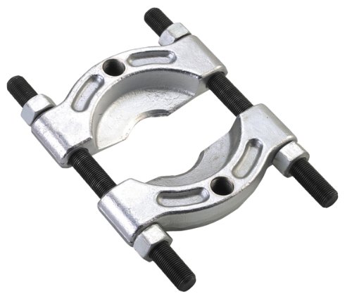

Take a brass punch or maybe even a large socket and see if you can get it to move back on the shaft towards the motor some. Once you get it moving it will probably come off pretty easy. If you use a three jaw puller what I have found works is to tighten up the puller as tight as you can and if it doesnt move smack the end of the puller with a hammer. Then tighten it some more and repeat.
If you can get hold of something like this tool they work even better and wont hurt the sprocket:
https://www.harborfreight.com/Bearing-Separator-and-Puller-Set-62593.html

I have worked around sprockets and pulleys much of my life. The issue you have is that the elements have fused those two together. Use some real penetrating oil on it over night to convert the red rust to black rust, and that will reduce the friction between the two. That means you need something stronger than ATF and Acetone. Use Liquid Wrench or PB Blaster.
Find someone with a press and a bearing plate they can put behind the gear. Then you can use either a press or a good two finger bearing puller on the plate. Be 100% sure any grub screws are removed first. Try to stay away from drifts and punches but if you do use one make sure it is a brass one. Do NOT use a steel drift.
or
You can use one of many different pullers like the Kuko above with the bearing separator plate or even one of these if you can find one that fits right. Make sure what ever you use pulls on the hub and not on the teeth.
or
I don't agree with the above considering that this most likely a tapered hub sprocket, and the two threaded holes on the face and the split line. If you confirm this is not a taper lock then the above is right on.
