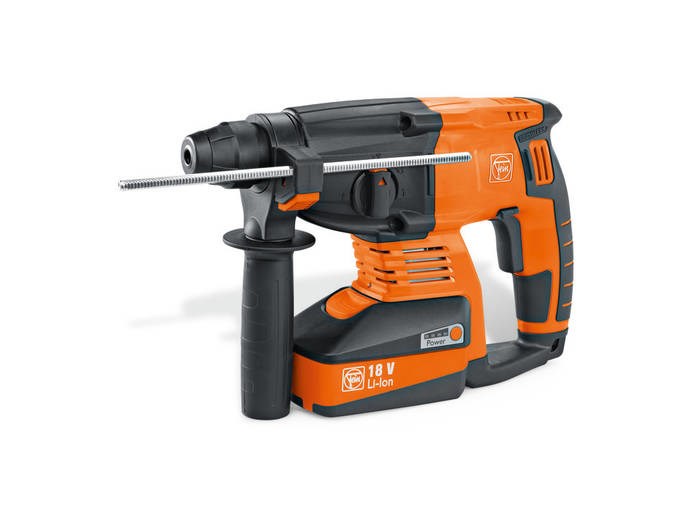

To close the circle, I ended up buying...this German-made* Akku-Bohrschrauber
First, I went to HD to sample all of the mainstream brands. They had a display where I could actually try unscrewing a screw in each one, which was VERY helpful. My notes:
Makita 18v xlr -229 with 2 batt and impact
+ Nice black, comfortable grip, compact
- odd gap btw body and chuck, shadow from light over trigger
Ridgid r86116k -179 w/ 2 batt
+ nice side handle system, light atop battery, cordless router available!
- ugly, shell fit a little dodgy, grip joint on back felt in hand, no router in store
Milwaukee 2701-22ct -199 w/ 2 batt
+ better fit/finish than Makita/Dewalt/Ridgid
- horrible grip (forces thumb into safety), side handle way way too long, shadow from light over trigger
