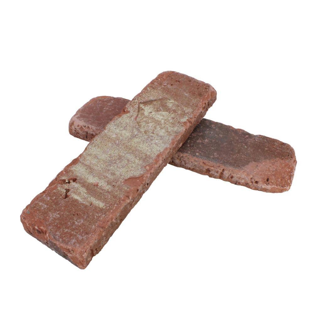

I need to cut a 5/8" veneer off std sized red clay bricks. (long story - but I built a bench assuming brick veneer would be available but lead time is ~4mo - so I bought full size bricks to cut myself).
I have a 10" wet saw which I've used for tile. It cuts the bricks pretty easily but when slicing the veneer lengthwise the blade walks (always "out"/the same direction. I don't get uniform veneers and sometimes the saw loads up/binds.
I checked alignment of blade to the table/slide and it looks good.
Looking around a bit, it seems perhaps a segmented blade may be better for this?
or, perhaps this is what happens when cutting something thick with a worn blade? I've used the blade before over the years, but no memory on how much. Visually, I can't tell if it's bad, I still see some sparkles/diamonds in the cutting surface but don't know how much is normal. I've wondered if the blade is walking because one side is worn more than the other causing the curf to be biased towards one side.
I've not experience in this other than weekend projects and was looking for advice on what kind of blade might be better for bricks and/or other advice on what might be causing my problems.

I would start with a new blade, it’s possible the diamond chips are worn off one side causing the blade to wander. Also be sure the blade nut is tight.

Sounds like blade is either shot or not the correct type for what you are trying to do. My good tile saw was (unfortunately no longer have it) an MK Diamond it handled everything i threw at it with no issues at all. They recommend a segmented soft matrix blade for wet cutting brick. https://www.mkdiamond.com/masonry/bld_wseg_10.html

Thanks for the responses. I'll look for a new segmented blade and see how that does next.

just fyi if anyone searches for same in the future.
I bought a Makita 10in segmented diamond blade at HomeDepot. It's significantly thicker than the diamond continuous blade I was using.
It cuts perfectly straight without any wandering on my wet saw.
thanks again for responses
