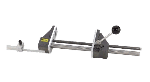

Respectfully disagree with the advice offered. Get a Heinrich Drill Press Vise or (2nd choice) Wahlstrom/AMF float-lock vise:
They both have a safety bar that either clamps to the drill table or rests against the column so the drill bit doesn't stick in the work and spin your vise/workpiece.
I have used everything. The best shops I know use these on their drill presses, and I also have them at home.
