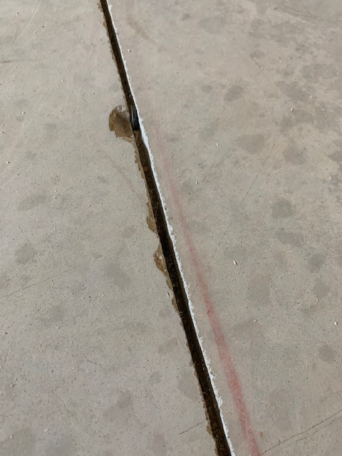

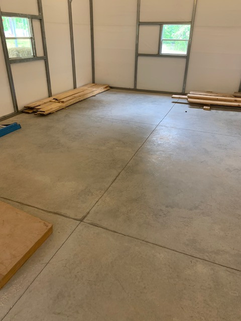

Advice on garage floor and filling damaged contraction joints
I've been doing a lot of reading on the internet and I need some advice on what to do on our garage floor. Our initial plan was just to seal the floor, nothing fancy. However, the contraction joints really bother me. I was initially going to leave them but the contractor that did the job cut them too early and a lot of the edges look horrible, even a couple small chunks missing (see pictures). However it was hard to complain after the fact because it was a friend that did it at a heavily discounted rate. So anyway, now I'm looking at filling the joints before doing anything else but I don't want to sink a lot of money into it. The wife really wants the natural concrete look but I don't know if that's the best option after filling the joints because I'm sure the filler will make a mess and it would probably be better to paint or epoxy afterwards. Any thoughts on which route I should take? I'm really not looking for a fancy epoxy floor, just something to clean it up and seal it.
Thanks!

I should note that this isn't actually a garage, it's more of a outdoor living area where we'll have stuff including a kitchen. It won't have vehicles or any heavy equipment in it so I don't need a top of the line finish for the floor or anything. I'm really leaning more towards some type of floor paint rather than a epoxy.
So the main question is what can I do with the cracks that will also knock out the damage in one step where I can sand it down then paint over it for a seamless look?

We would recommend using a coat of our clear SPGX one part Polyurea and then filling the joints with a color matche Polyurea caulk. Trying to fix the edges is tough.
Don’t fix the joints first as when the slabs move it could create cracks in your coating since coatings are not flexible
Check out RS-88 caulk online it comes in over 50 colors and the mfgr will send out free sample chips to match your concrete exactly.

It won't take stain so repairs will show but maybe get it in gray and use gray stain to make them less noticeable. You can use any clean, dry sand for filler and grind or sand it after about 20 minutes. Don't mix more than a few ounces at a time in a plastic squirt bottle as it cures fast!
