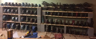

zoomieport
Nov 21, 2011
1,803
The Mall City
DON'T DO IT!!!:wtf:
YOU'LL END UP LIKE ME!!!!!:shocking:
Take Care!:thumbup:
ZOOM

Lol zoomieport...let me know if you need to free up some space over there! Id definitely be willing to buy one of your smaller wiltons that needs some work!!
Thanks guys!
va.grouseman
Mar 26, 2011
4,965
Southern-Central VA.
Yea Zoom, how are you going to get the insurance Co. to pay for your cracked foundation, and cracked floors, and cracked walls.---They are going to take one look at your museum and say "we're not paying for that":D
