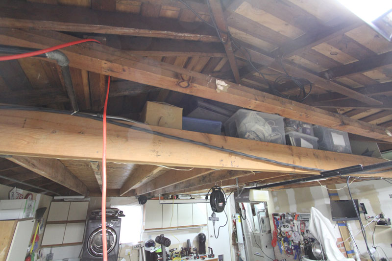

Hey folks,
Apologies for breaking this out of my last thread, but I think (+hope) this is enough of a departure to see if I can solicit some additional advice.
I have a long header with an open span supporting a storage loft:
Supported on opposite ends by 4x4s (note one end has an angle cut out of it for the roof, the other end is square):
I plan to drywall the ceiling/bottom of the loft, hang a ton of lights, and continue to store a bunch of stuff on top. A concern was raised about the wide, unsupported span, and I'm leaning towards agreeing with the concern (considering I hang out underneath it a lot, and park a car there the rest of the time).
My question is are:
1) what would be sufficient/slightly overkill without being over-overkill? Should I sister in an additional 4x10? Is a 3x10 sufficient?
2) How best to sister the two pieces of lumber? Construction adhesive and carriage bolts? What size hardware? Any pattern to the fasteners?
Thank you very much!
Mike

I would use a taller beam, let it stick up above the floor above. Even just building a wall across the existing beam and sheeting it with osb or plywood, you could put 2 layers of sheeting offset by 4' so none of the seams lined up. That would really strengthen that beam. There are many ways to make that beam stronger as long as you are willing to have a wall from that beam up, that way you don't loose headroom underneath.

I would take two metal straps say like 3/16"x3"xX length (what ever the measurement from the top of your hip to the bottom of your beam) drill 9/16" holes at each end and bolt one side to the actual hip and straight down to the center of the beam. Do this on both hips, with using flat stock, you will be able to twist the metal so it mounts flat to both surfaces. Then bolt the metal strap to the beam and hip with 1/2" bolts. Since the hip has opposing force from two different angles it will take a quite a bit of load off your beam. This will keep your space below post free and probably give you more support then sistering in another beam. If you sister in another beam your weak point will then be the angle you have to cut on the end of the beam to miss your roof line.
This is very interesting -- I was already planning to wall in that area later on when I start drywalling. I hadn't thought that part through at all yet, so I never considered the additional strength I'd get if I built the wall atop the existing beam... also, I imagine I'd have to tie that into the roof structure at the same time, not that I would want to get any strength from it, but there'd probably be some structural gain all around from tying all the various members together like that.
Paranoid question: With regards to the 4x4s supporting the beam, it's my understanding they can take massive loads (4000lbs/ea + according to most folks) in the vertical orientation, as long as they are not permitted to bend. Any thoughts on that? I feel like I'm putting a lot of weight up there, even though it's nowhere near the purported limit.

...bolt one side to the actual hip and straight down to the center of the beam. Do this on both hips, with using flat stock
Thanks duc, can you elaborate (or at least define, pardon my ignorance) what the hip is? I'm having trouble picturing the overall design you're describing.

Ducati is basically showing a variation of a truss.
I agree with the idea....but I think you can improve on it by also glueing and nailing some 1/2" OSB to the end of that joist. There was another thread about making some floor joists stiffer....after advice for here, he ripped some 7" wide strips of OSB, glued and nailed them to his floor joists. Was extreemly pleased with the results....doing just one of them made a significant difference.
So, if you do the hip and OSB, I think you will have plenty of margin.

A stout piece of angle iron lagged to the side and bottom of that header may do the trick, make sure you have plenty of bearing on the ends, might be worth adding additional jack studs on each end. Hard to tell from pics what type of building that is. Hippped roof? Not much in the way of ceiling joists which prevent walls from spreading from roof loads? If thats the case I'd be careful attaching anything else to the roof structure without consulting somebody who can come out and look at the structure in person.

Crawdad's comments do raise some concerns, though, as it is a hipped roof.

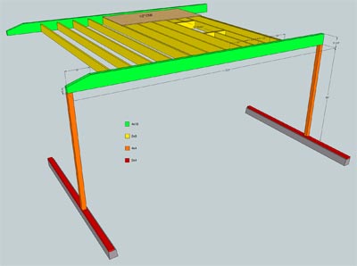

Whipped this up with all the requested dimensions (click for full version):
Wood species is all doug fir.
The far end 4x10 is bolted into the side of the wall, into every stud, 16 o.c. for the entire span of the header.
Current load (1550lbs.):
- Garage doors, when open (can't find exact specs... 16x7 steel+insulated, most say around 250lbs).
- 1000lbs. (est.) in storage, evenly distributed
- 300lbs. of 1/2" OSB (52lbs/sheet)
Ideal load (2165lbs. minimum, ideally with a nice big safety margin):
- 1550lbs. (all the above weight)
- 415lbs. drywall (based on 2.2lbs/sq ft of 5/8" drywall – not counting the weight loss in holes cut for recessed lighting)
- 200lbs. lighting (10x 20lbs troffer lights)
Let me know if you need additional information/accuracy on anything.
Thanks!
Mike

Here you go:
Span 18-4
Area 14-6x18-4=266SF
Present LL=1000#/266SF=4#/SF
Future Dead Load:
Joists 37x11=407#
Beams 60x4=240
DW 450#
OSB 300#
Lights 200#
Garage Door 250#
Total 1847#
1847/266=7#/SF
LL+DL=11#/SF
Beam contributing area=133SFx11#/SF=1463# Total Load/18.33=80#/LF
2-2x10's Doug Fir #2 is an adequate beam for this application
If you want to store more weight just change the LL amount and recalculate
For example, if you wanted to use a 20#/SF LL to store 5320# Total:
Live Load 20#/SF
Dead Load 7#/SF
Beam Contributing area=133SFx27#/SF=3591# Total Load/18.33=196#/LF
2-2x16's Doug Fir #2 is an adequate beam for this application
Note that I added the weight of the joists and beam to the dead load.

Amazing... I don't think I would've ever figured out how to calculate the load specific to the beam.
Does the angle cut out of the left-side of my 4x10 to fit under the roof have any bearing on any of your calculations? Or is that not compromising the strength of the beam as much as I would imagine?

The main thing is NOT to miss anything, like including the weight of the existing structure in the deal load. Also figuring the area contributing load to the member in question is important. You always need to look for unusual conditions like the garage door load. The stairs are a load but it is countered by the fact that no storage occurs there. Your weight is also a load to consider if the design was close to being overloaded, but there are safety factors built into the calculations. This is designed for a deflection of 1/360 of span. Good stiffness to avoid cracking for drywall. If you had a very heavy load, you could turn the beam into a truss to add capability or shore it up and replace it with a deeper beam that extends further up than the present one, or you could sister on some material (also extending up if needed) either wood or metal to get the strength needed.
